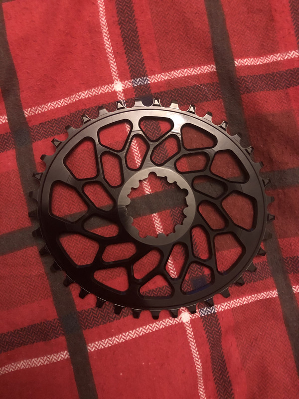

I have taken the plunge and gone for an ultimate black oval chain ring to get me over the Pennines without tearing my knees to bits.
On first impressions it’s very oval’y.
More updates when it’s fitted.

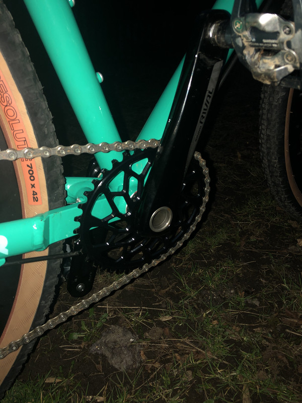

I love mine.
https://flic.kr/p/VEepzC
Posted : 08/03/2021 7:05 pm

Posts: 598
Well it arrived folks and it has been fitted
By the way it has been fitted to my new Sonder Camino
Posted : 10/03/2021 10:39 pm
