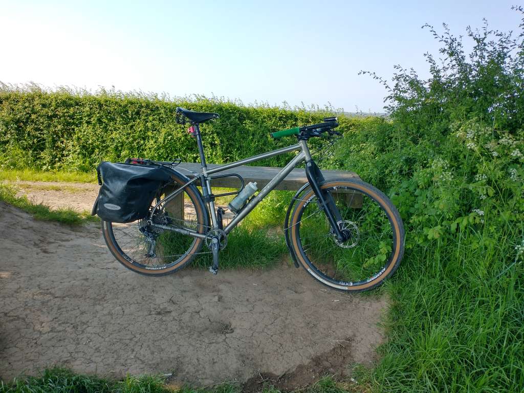

Posts: 3438
@hardtailonly
I've got a vandal set up with a ridgid fork an 50c gravel tyres for commuting with some gravel/ light singletrack on the way home.
600 miles in and it's great. Mostly commuting on the road 8 miles a day with a few longer gravel rides. I should have gone with something with rack mounts. The p clips I've got the rack attached with have given be a wee bit of trouble.
It was down to 10.? Kg as bought
It's gone up with the rack, mud guards, lock, Jones type bar and a big sprung brooks saddle 😃
Posted : 16/11/2023 11:16 am
Posts: 3438
IMG_20230416_210838682_HDR
It IMG_20230609_164909716_HDR
Posted : 16/11/2023 11:18 am
