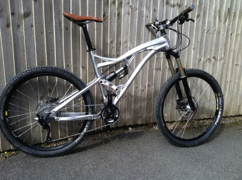

hello, hers' mine:
i'm running the following on my CCDB Air
HSC: 3
LSC: 15
HSR: 2
LSR: 9
use this link to help set it up [url= http://forums.mtbr.com/9390123-post139.html ]click me[/url] it's worth spending a couple of hours fiddling with it and finding what's best for you tough as everyone is different....

It's a super raw frame.
