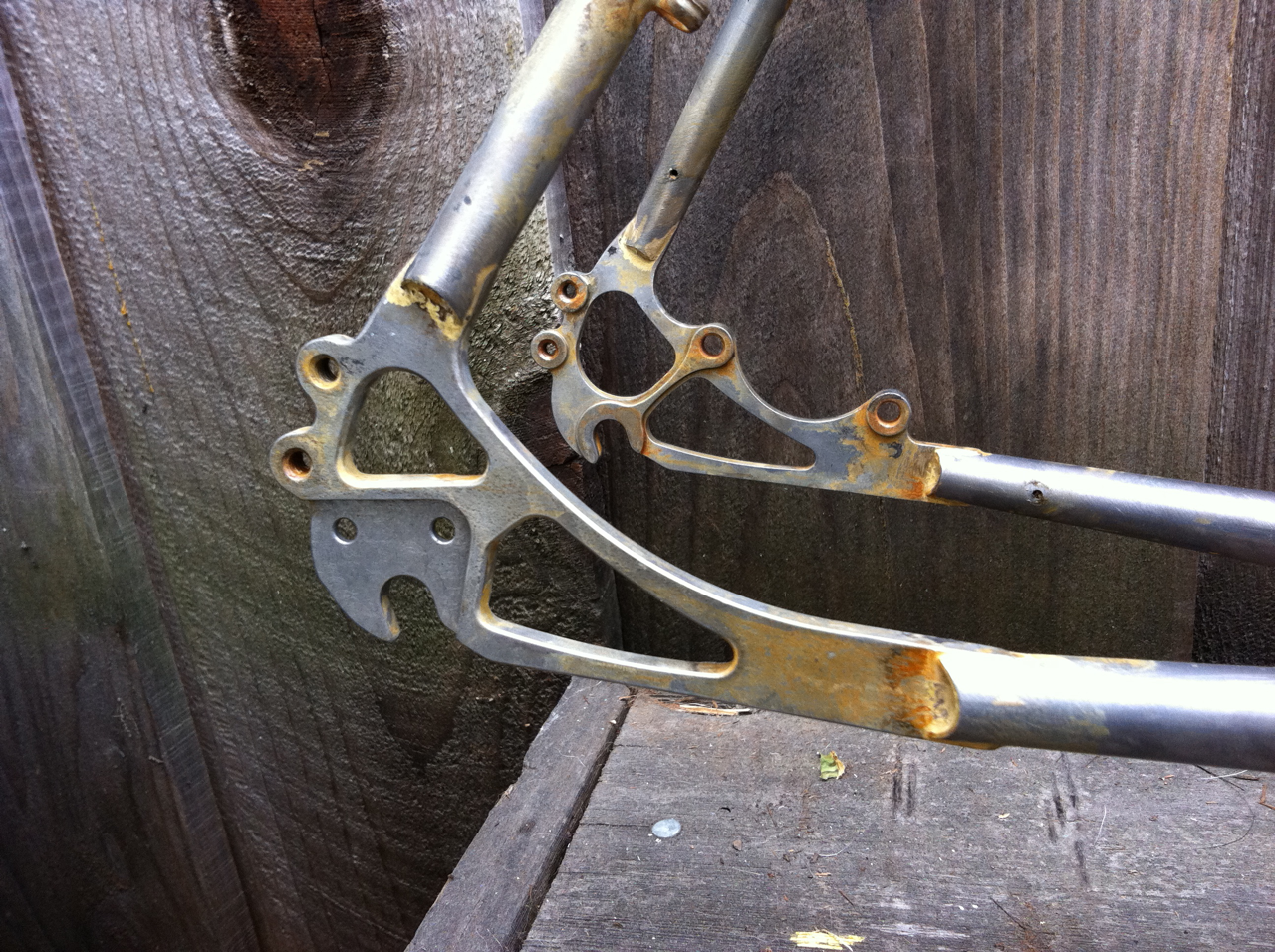

This is the mounts at the back end of my bike, although I'm not using a rack:
The brake mounts aren't quite as I had envisaged, the one on the seat-stay being a bit clunky and industrial looking, but they do the job OK.

It's a very neat and tidy looking set up though. Another thing I need to consider, is whether to use post mount or ISO disc mounts. Most calipers seem to be of the former these days, so maybe better to use them, as I'd rather not be faffing with adapters and stuff. Any thoughts on this?
"And isn't getting a frame made out of titanium with features such as the brake optionality so it can be repaired anywhere a bit counter intuitive?"
I'm agonising over this. I have XTR and Avid Ultimate V-brake options, and v-brakes are pretty ubiquitous these days, so there's greater chance I'll be able to find spare bits in an emergency. This would of course necessitate wheels utilising rims with a braking surface, but there's little or no issues or weight penalty there, so not a problem. I could have removable v-brake pivots, although this would still present an aesthetic compromise.

The Shand droupouts look very flexible, and although it might be expensive doing it all in Ti, there isn't any reason why the black part shouldn't be aluminium to reduce the cost. Also easy to incorporate a split in the rear triangle should you want to try a belt-drive in the future.
Post mount is so much simpler for centring callipers without the need for shims. I'd also say that they're possibly a bit more forgiving in the way the braking forces are transferred to the frame.
Adding V-brake mounts seems a little counter-intuitive to me if starting with a blank canvas and designing in disc mounts. They look very ugly if not used, far more so than not using a calliper brake mount for example.

shands variation looks good but needs a tensioner or EBB to go rohloff.
that troll looks awful.
Im a fan of the whole lot sliding together through a sliding drop out as the wheel can be removed and put back in the correct place without readjusting your dropouts/wheels/brake etc IF running a rohloff is a posibility for you...
Or what about the salsa swing drop out - that does similar but even neater imo although with less adjustment.

"it might be expensive doing it all in Ti, there isn't any reason why the black part shouldn't be aluminium to reduce the cost"
Good point. Definitely something to consider. Of course, certain dropout designs may be patented, so other builders may be prevented from legally using/copying the same design.
"Adding V-brake mounts seems a little counter-intuitive to me if starting with a blank canvas and designing in disc mounts. They look very ugly if not used, far more so than not using a calliper brake mount for example."
Yeah, it's a conundrum. But as I've said, I have some very nice V-brake options, as well as a lovely set of Hope/Mavic wheels which I'd like to continue using. A disc brake mount won't look too obtrusive or ugly if I'm using v-brakes, and gives an option for the future.
