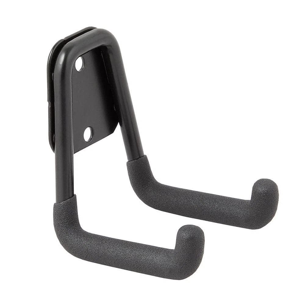

I don't think the forces will be an issue, but an easier solution might just be to put one of those "spade handle" hooks on the wall (a pair of small hooks), and hook the replaced axle of the fork (after wheels removed) into it (which is way less faffy than trying to attach a fork mount)? there's no forces like there are in a car so it doesn't need to be super-secure.

Posts: 42
Sorry my bad, it will be my analogue bike being hung.
thinking some boards at floor level to grip rear tire.  Stop it swinging about and aid me when attaching to wall

Posts: 17728
I'd just take wheel out, replace axle in fork & then have some hooks in the wall to hook the axle over. Might be worth having a couple of hooks at the same height spread by 80mm or so, to stop the front end flopping round. Similar to that double hook that 5lab has posted an image of.

Posts: 12993

Posts: 42
Yeah 5labs’s idea seems the simplest. No need to reinvent the wheel 😉😂
Posted : 30/01/2024 2:03 pm
Posts: 42
Lab where did you get that image from

 5lab
Posts: 7921
US Ebay - but you can get similar things at screwfix
https://www.screwfix.com/p/smith-locke-mid-duty-double-storage-hook-zinc-plated-158-x-116mm/8733j

Posts: 5661
I don’t think the forces will be an issue, but an easier solution might just be to put one of those “spade handle” hooks on the wall (a pair of small hooks), and hook the replaced axle of the fork (after wheels removed) into it (which is way less faffy than trying to attach a fork mount)? there’s no forces like there are in a car so it doesn’t need to be super-secure.
This is the best option, I dabbled with a very similar hook in my old garage, worked well.
