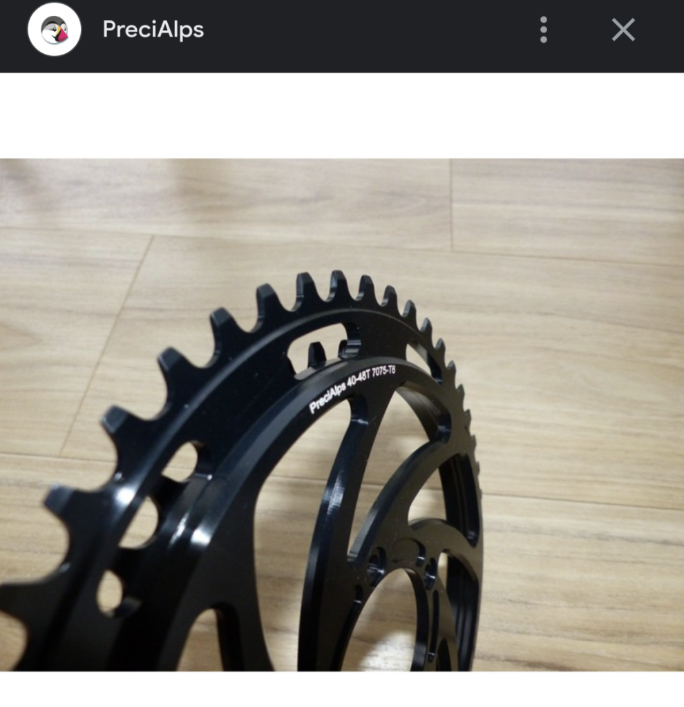

So in the spirit of less-is-more, I'm musing about a single bike to do both BUT my biggest quandary is gearing. I'd want (at least) a 50t cassette for the local exploring but I'm not sure what front chainring would suit both roles.
Then I had an epiphany! What about two chainrings without a front derailleur?
For local exploring, I'd use a small 28t. For bike packing, I'd use something slightly bigger (eg 32t) and just manually move the chain back and forth (with my fingers) when needed, without having to swop cranks or chainrings.
Anyway, turns out someone has done something similar already...
https://precialps.com/uk/accessories-bafang-bbs01-bbs02/42-plateau-double-42-48-dents-bafang-bbs01-bbs02.html
Screenshot_20240107-192042Screenshot_20240107-192042

You'll still be exceeding the capacity of the derailleur when you're in big-big or small-small. You'll want 2 chains to swap too.

You’ll still be exceeding the capacity of the derailleur when you’re in big-big or small-small. You’ll want 2 chains to swap too.
In my mind, I'd keep the difference in chain ring sizes quite small (probably 4t) and hopefully "someone" can program the SRAM AXS so that it has two modes (large or small chainring) and then avoids the "bad" end of the cassette so large chainring only uses the lowest/smallest 10 cogs and the small chainring avoids the lowest/biggest 2 cogs
Also, no need for any sort of mech or shifter as I'd only be changing chainring when I change from ride type ie I wouldn't generally use the smaller chainring when bike packing and I wouldn't generally use the larger chain ring when exploring local trails.
