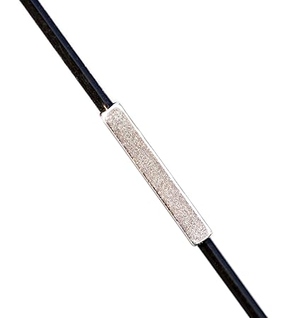

This kind of thing:
I've tried superglue and contact adhesive, and each time it's eventually fallen off. Anyone had any more luck then me?

Bit long-winded but only suggestion I can think of (other than using a different type of wheel magnet) would be using decent heat-shrink tube... but do do that you'd have to remove the nipple, unthread the spoke, put the heat-shrink on, re-assemble and re-tension...

Epoxy

Hmm, that sounds like a bit of a ballache (although I admit it would end up with a very neat end result)

Epoxy +1

Just use a Cateye non-slimline variety. My problem is normally removing them!

But they're ugly, and my bike is pretty :'-(
Not to mention they're less aero 😉

I'd expect any kind of brittle glue (e.g. superglue or epxoy) to fail before too long, as the spoke will be stretching/contracting ever so slightly each rotation, especially on rough ground. The glue won't want to flex as much so will eventually crack off. I'd try a more flexible glue like evostik, perhaps combined with some very thin wire or fishing line to wrap around the spoke to tie in place.

Tried. Failed 🙁

Sugru
You get heat shrink tape don't you?

Tape them on with heli tape?

How about either wrapping insulating tape around it or a number plate sticky pad?

Something like Sikaflex, Tigerseal and some 3M insulation tape around the outside. I think the heatshrink idea is probably the best idea.

JB Weld?

If you are so worried about how pretty your bike is then ditch the magnet based sensors and get some accelerometer based ones, no magnets required.
