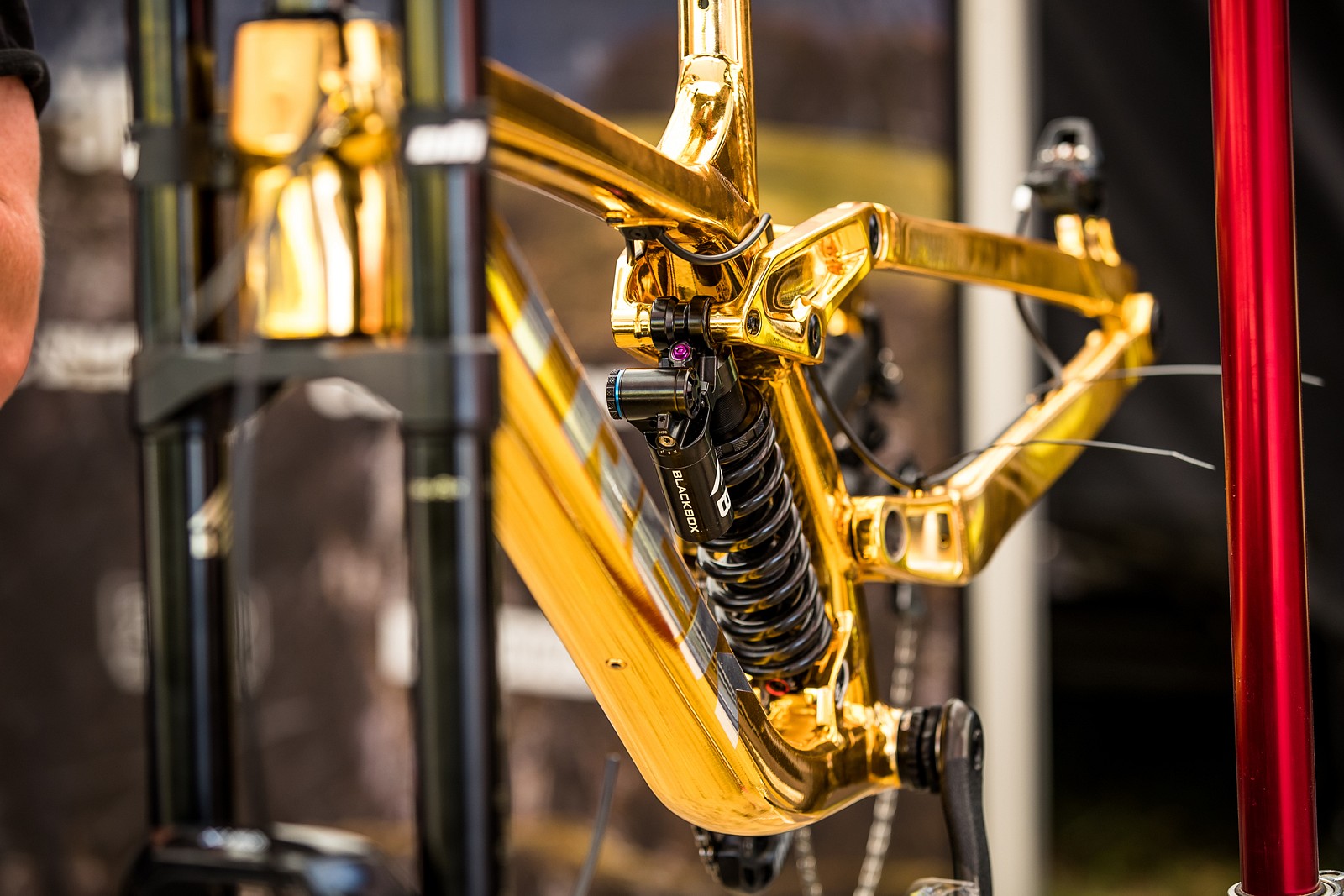

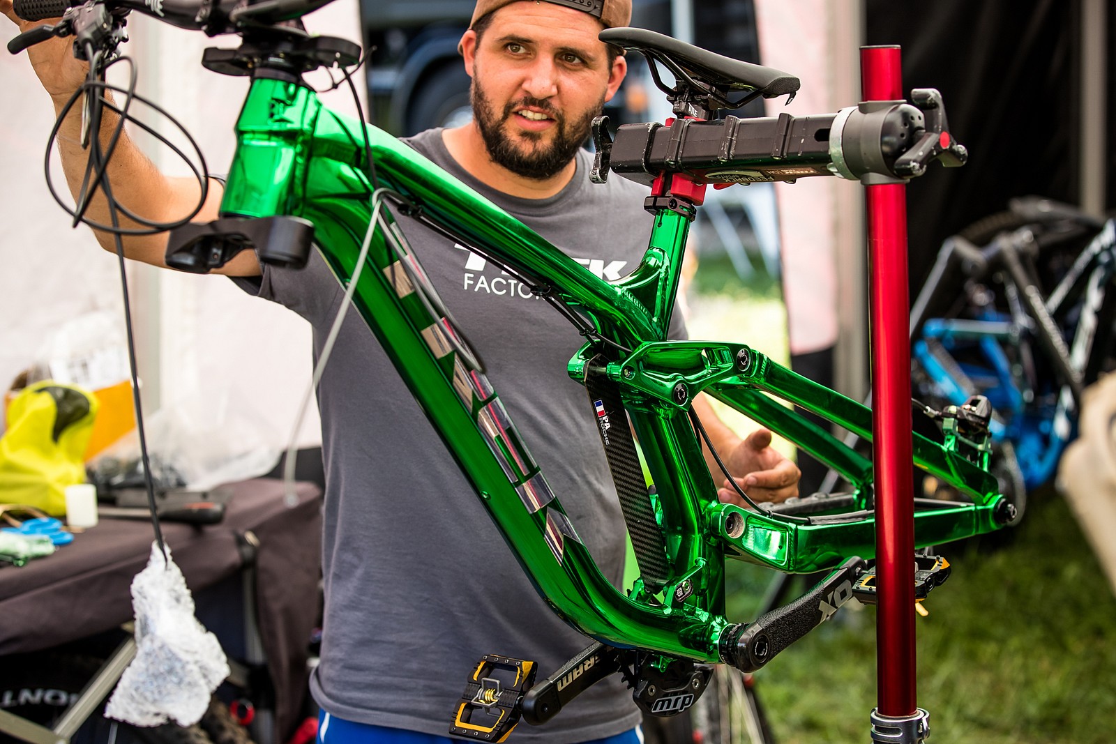

Not to everyone's taste but stunning in my eyes, it's like anodising on steroids, where can I get this done to my frame.

Most painters (JMJ, FatCreations etc) offer it. Not cheap mind.

Vergiers even gone for green ti bolts and brake adapters to finish off, looks amazing but matching fork lowers would take it to the next level.
Reece's matching gold helmet is a bold choice, he needs to ride a bit faster tomorrow to back that up.

Possibly a tinted clearcoat over a silver basecoat, like a thin candy colour?

It will likely be candy over chrome, you paint the bike black, then a dry chrome paint (unless they’ve changed that process, it’s a very dry spray which you might not “get” unless you’ve painted), then candy and then clear. Www.specialistpaints.co.Uk have all that you need,

Gloss black, then easy chrome which is expensive, I've seen it for £40 a can, then a candy colour over the top followed by a 2k clear coat, you might be able to DIY for around £100.
