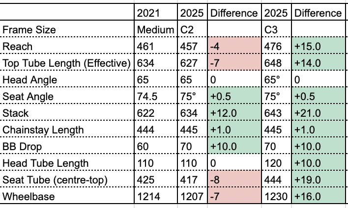

Is anyone riding the new BFE that can comment on the sizing?
I was on the previous gen medium frame and I'm 5 10", wondering if I should go C2 or C3 and the previous medium was bang in the middle.
Posted : 16/10/2025 4:51 pm
Posts: 13942
Looking at the reach and stack, the old medium is the same size as the new C2. The older bike’s ETT is longer because of the slacker seat angle though.
I’m just over 5’10 and I’d get the C3 - it’s super close in geometry to my Moxie which rides brilliantly.
Posted : 18/10/2025 12:06 pm
Posts: 1715
I'm edging towards the C3. I had a 35mm stem on the medium originally and ended up changing it out for a 50mm, so if I drop down to a 35mm stem again it evens out the increase of Reach and ETT length. I've been using a DMR stem to increase the stack so the extra 20mm there is fine.
Posted : 18/10/2025 1:41 pm
