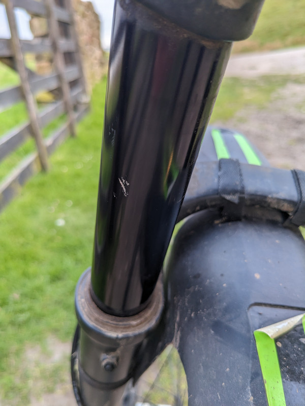

Not ride ending but very very annoying.
Half way down a hill, on the absolutely not techy bit, the stone I was riding over moved, a lot.
Otb and dust bath, dead leg from the saddle, which rotated 90 degrees when I belted it, ah well, easy fix and no harm.
But, as I go to move the bike realise theres one bloody big rock on the hill and my forks have found it.
Still, glorious day for it.
