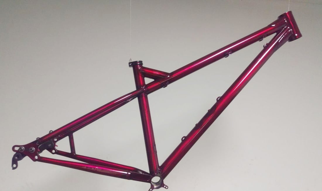

Mate of mine had a full custom steel ht from a guy callling himself smalltown boy designs, was 450 quid, 2 years ago.
Thanks! Will contact, my only gripe is that custom bikes don't have a history of durability the same way a factory frame can have.
