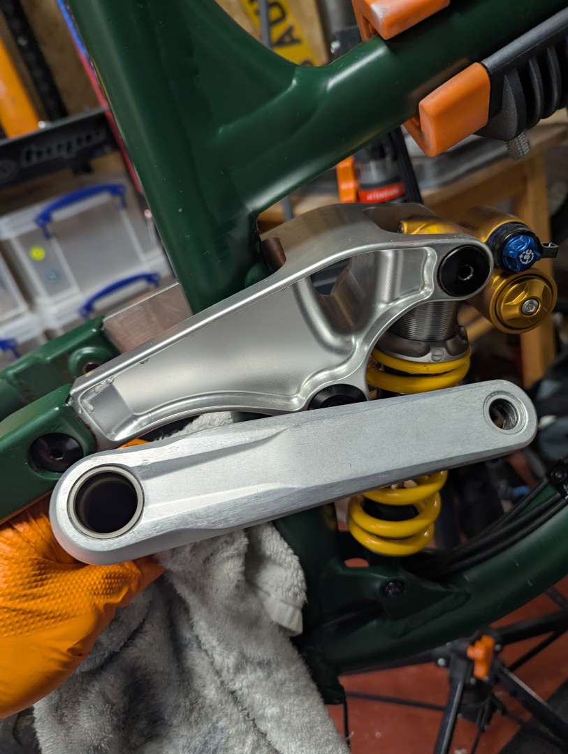

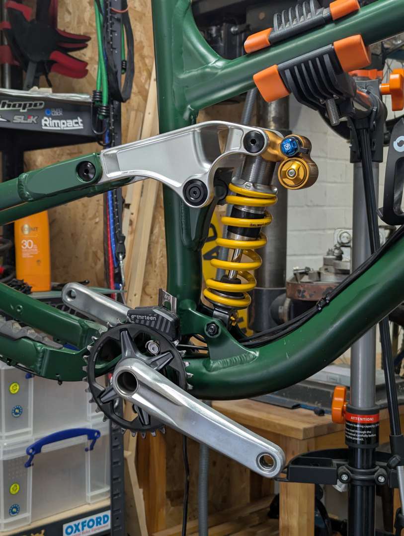

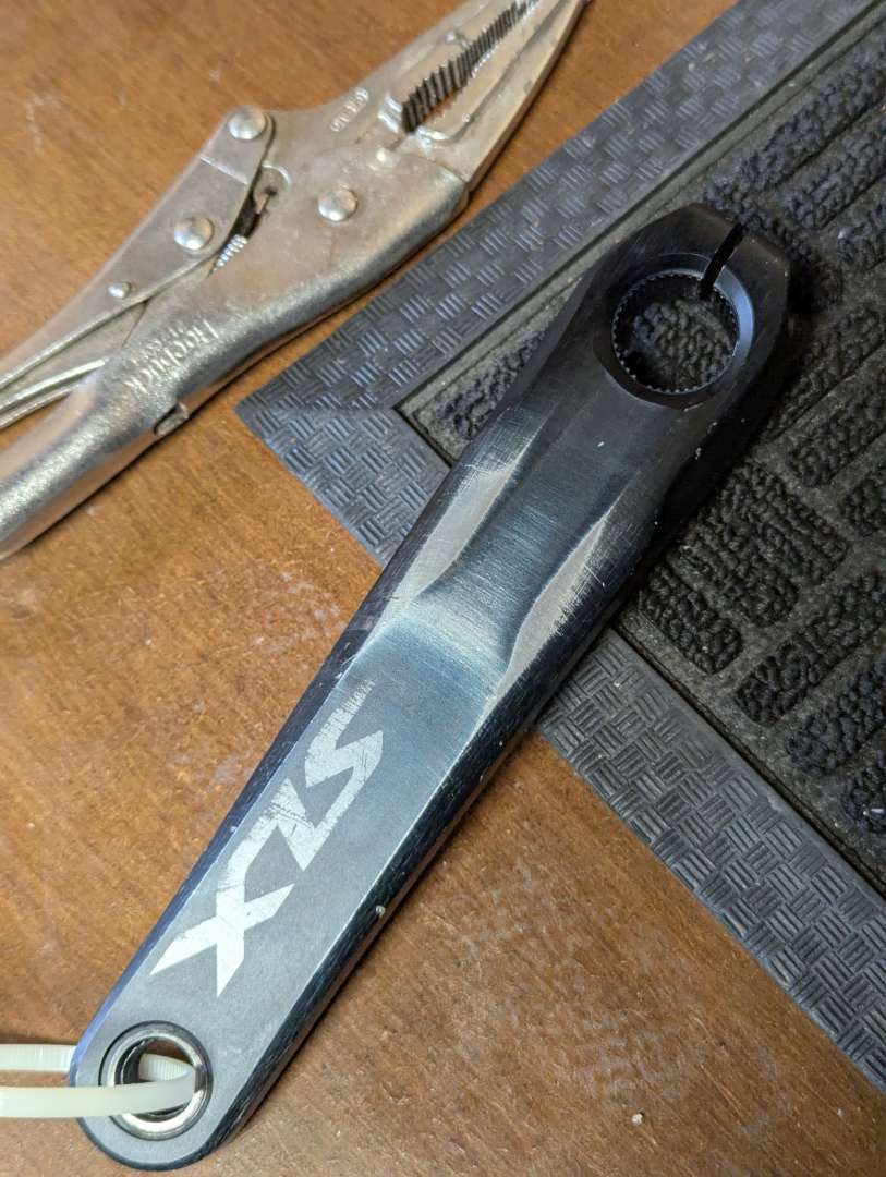

I can't afford Hope cranks yet so I've spruced up my SLX ones. They're still too long but I'm very happy with how they came out. Absolutely minimal effort.

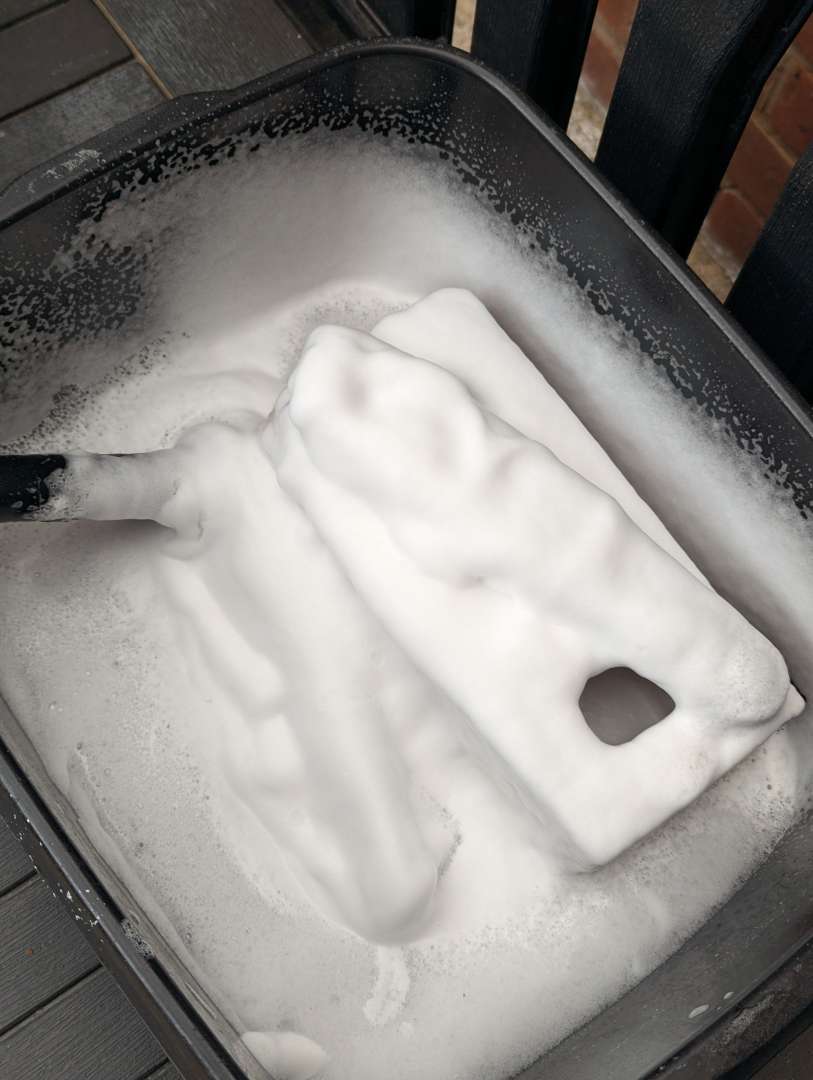

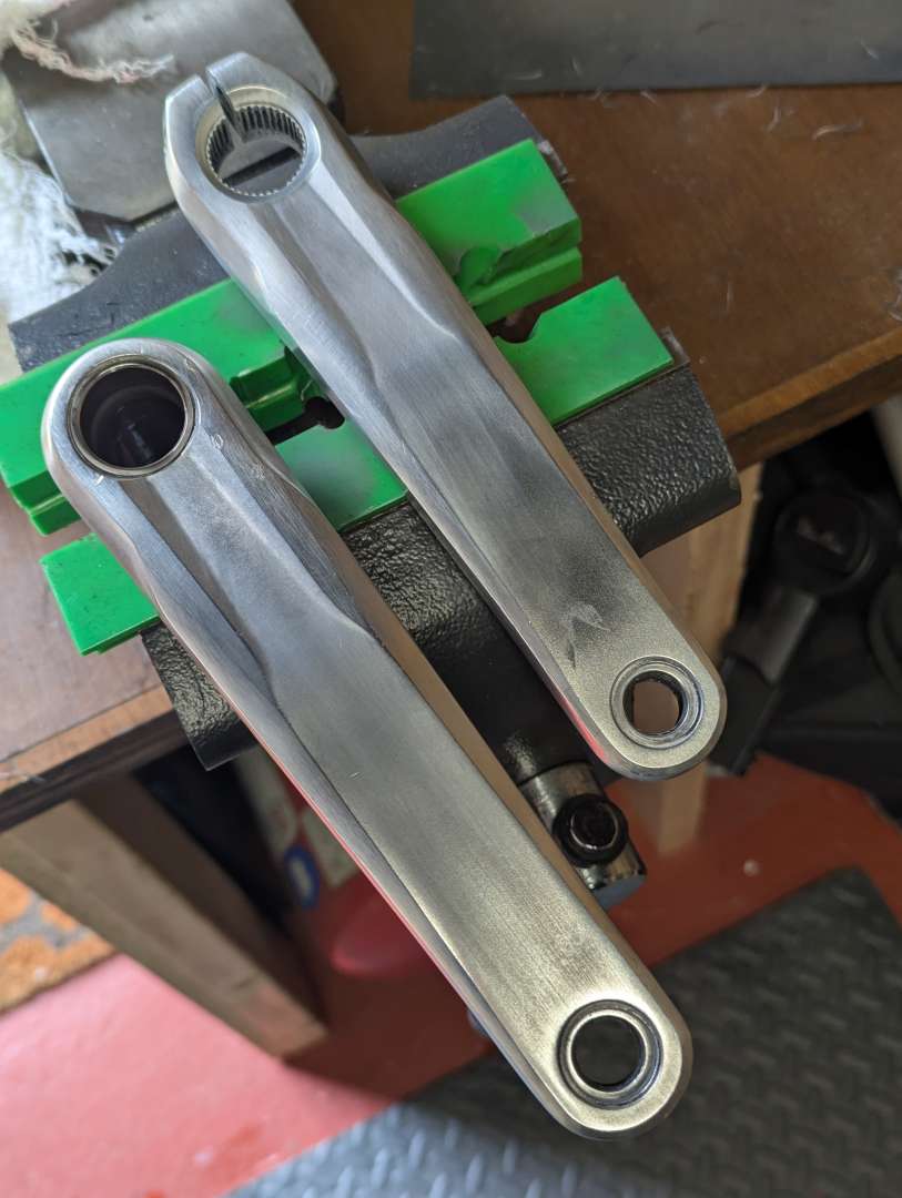

I couldn't find caustic soda in any local shops so I bought spray on 'Elbow Grease' foamy oven cleaner. Soaked the arms for about an hour then used Autosol on a polishing mop fitted to the drill.

The problem is now I'm looking around the garage for other stuff that needs to be de-anodised.
I might end up with a fleet of polished bikes.

They came up nice. Are they likely to oxidise without the anodised layer?
Posted : 27/05/2025 8:56 pm
Posts: 16025
After about 5 minutes, IME.
Posted : 27/05/2025 10:23 pm
I've XTR ones I bought from someone who'd done this. They do grey a bit... but the rest of my bike looks pretty shitty anyway so i don't bother polishing them.
Posted : 28/05/2025 12:49 am
Yeah it'll definitely oxidise pretty rapidly. I'm riding for 2 days this weekend, so we'll see how they look after that.
I'm tempted to do the SRAM cranks on the other bike now. Maybe a derailleur if I can take it to bits.
Posted : 28/05/2025 6:23 am
zerocool reacted
Yea, but, no, but.....
Aluminum is far more reactive than iron so oxidizes far quicker
Aluminum oxide is more dense than aluminum, so it doesn't flake off*.
Aluminum oxide is harder than aluminum so doesn't wear off the surface.
The result is it will dull almost immediately, but beyond the cosmetic it's not usually a problem.
*Iron oxide is less dense than iron, and it's that which cases it to be pushed off the surface
Posted : 28/05/2025 9:22 am
The question's always more how it'll oxidise than whether it will, if you're unlucky you get the white fur and it looks crap instantly, especially if it gets salty, but if you're lucky it'll just darken and look kind of drab and dirty. But still looks better than hammered old cranks tbh, or 5-second-old Shimanos with shoe rub Quick scotchbriting will usually bring them back up though.

I use drain cleaner instead of oven cleaner so I can see it working rather than guessing  how long to leave the foam on.
