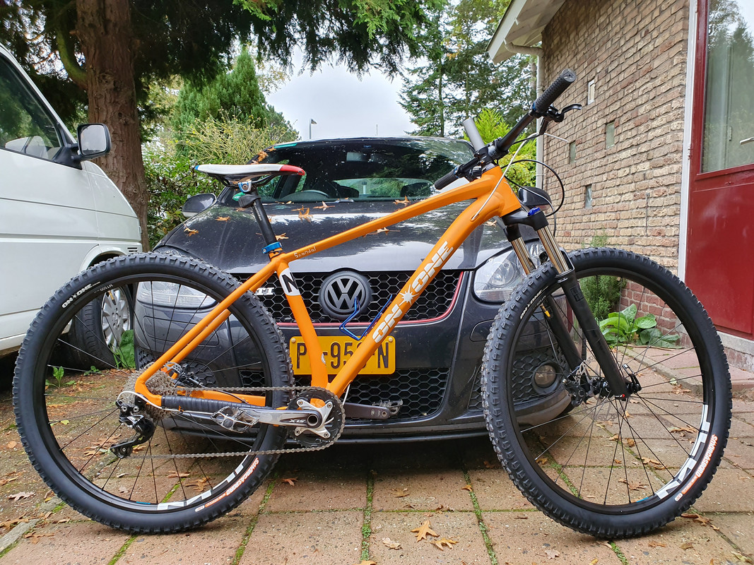

Well it's arrived and was delivered to my neighbour as I was out, although Planet-x had said it was being returned to sender.
Also got several e-mails saying the replacement order (with the build yourself discount) is being built and shipped next week.
Ahh well, sort it out on monday. In the meantime it is VERY orange!

Posts: 424
Just finish building mine. Fork steerer still needs a trim and I may have the get new brake hoses as they're both on the short side.
Probably the last time it will ever been clean!

Posts: 3783
#howmtbusedtobe (but with a dropper)
Just got back from my first ride, 30 smiles today, 3000ft of climbing, mixture of road, mud, gravel, roots, stairs, drops, big climbs, long descents. Loved it.
Mines all retro, 1x10, bar ends, inner tubes, 2 finger braking, rigid forks, mudguards and not forgetting the mount for the bar bag.
[url= https://i.postimg.cc/6q4bbBJ0/20191012-120602.jp g" target="_blank">https://i.postimg.cc/6q4bbBJ0/20191012-120602.jp g"/> [/img][/url]
[url= https://i.postimg.cc/mkFR3xdx/20191012-131308.jp g" target="_blank">https://i.postimg.cc/mkFR3xdx/20191012-131308.jp g"/> [/img][/url]
[url= https://i.postimg.cc/bYQqvP2b/20191012-140418.jp g" target="_blank">https://i.postimg.cc/bYQqvP2b/20191012-140418.jp g"/> [/img][/url]
Unfortunately mines not limited edition. Here's a gate in front of a gate.
[url= https://i.postimg.cc/bNN4jf0q/20191012-143116.jp g" target="_blank">https://i.postimg.cc/bNN4jf0q/20191012-143116.jp g"/> [/img][/url]
The on one stickers are not coming off! They are under the lacquer. Do you sell black ones I can stick over the top for a stealth look?
Posted : 12/10/2019 3:57 pm

Posts: 1088
My gx build turned up yesterday, changed the bars for something wider then tried to fit my dropper . Word of warning about the internal dropper routing port , it’s very easy to drop the screw through the empty hole ...twice ..doh . Managed to get them back but had to take the forks out . I also realised to late my spare dropper is to big for the seat tube but have just ordered one of the canyon ones of eBay so not to bad .
all in all I’m pretty pleased with it , seems well put together and the orange looks really good . Certainly can’t complain for the money .
