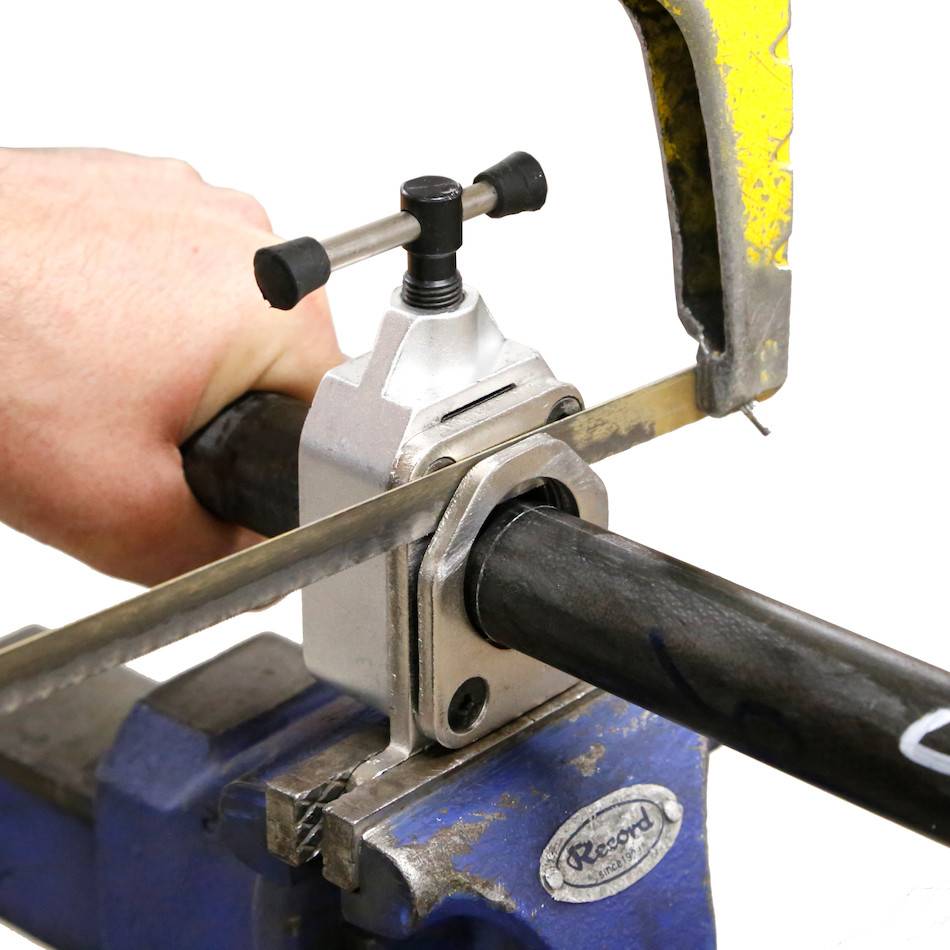

So last night I spent an un-eventful 20 mins cutting a steerer, and installing a star nut. Who knew that by using a saw guide and a star nut setter a job that always been a been a bit of a 'mare can be done easily and simply? I mean; I'm unlikely to use them again in a hurry, but having a perfectly cut steerer and a straight star nut is more than worth the 25 quid they cost.

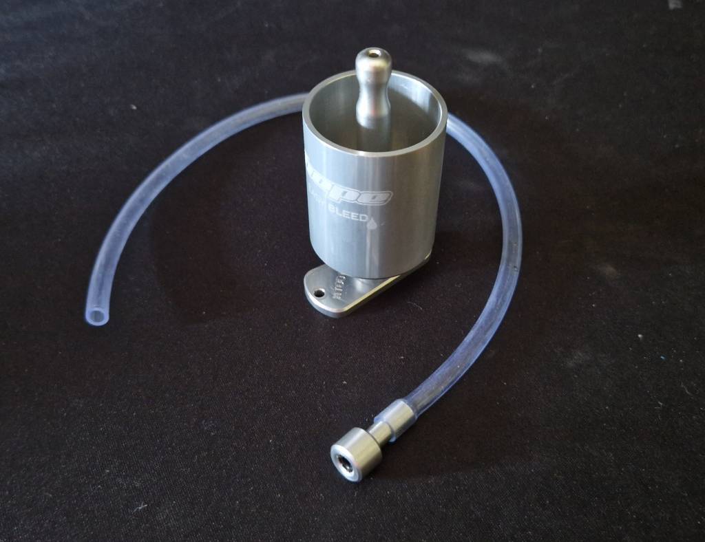

The little 3d printed bleed tool that allows one piston to extend at a time on 4-pots also falls into this category.

I use one of these for steerer tubes
Takes ages but it's perfect every time and no need for deburring. You might get a clean cut with a saw guide but it can still be wonky.
Posted : 29/06/2023 2:46 pm
bikesandboots, fasthaggis, thols2 and 3 people reacted
I used to use one of those until I realised it was not actually cutting material away like a saw does, it is just forcing its way into the metal which raises a ridge on either side of the cut. The result is a lip on top of the steerer which needs a fair bit of filing off if you have a tight stem. What I do now is use one of those to make a line then saw my way around it turning the fork as I go.

I also used to use one of those. A saw guide and a saw is much better. The raised ridge is a pain. Plus most of those tools are cheap crap and have loads of slop in them.

Yeah, I've used and broken those pipe cutters in the past. I think they're fine for thin copper plumbing, but struggle a bit on a steerer tube.

Similar. Bought a more expensive bleed kit with nicer syringes and better fittings and it's a joy to use. Still not perfect but much easier than the crappy things I used to mess around with

I have a saw guide and a pipe cutter, I prefer the pipe cutter. I don't end up with a lip but I always go round with a file to smooth the edges anyway

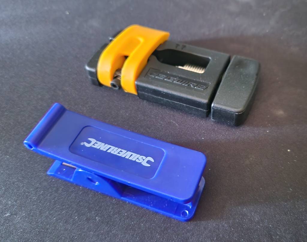

One of these…. after years of wonky cuts with stanley knife or cable cutters… a 2 in 1 lovely thing

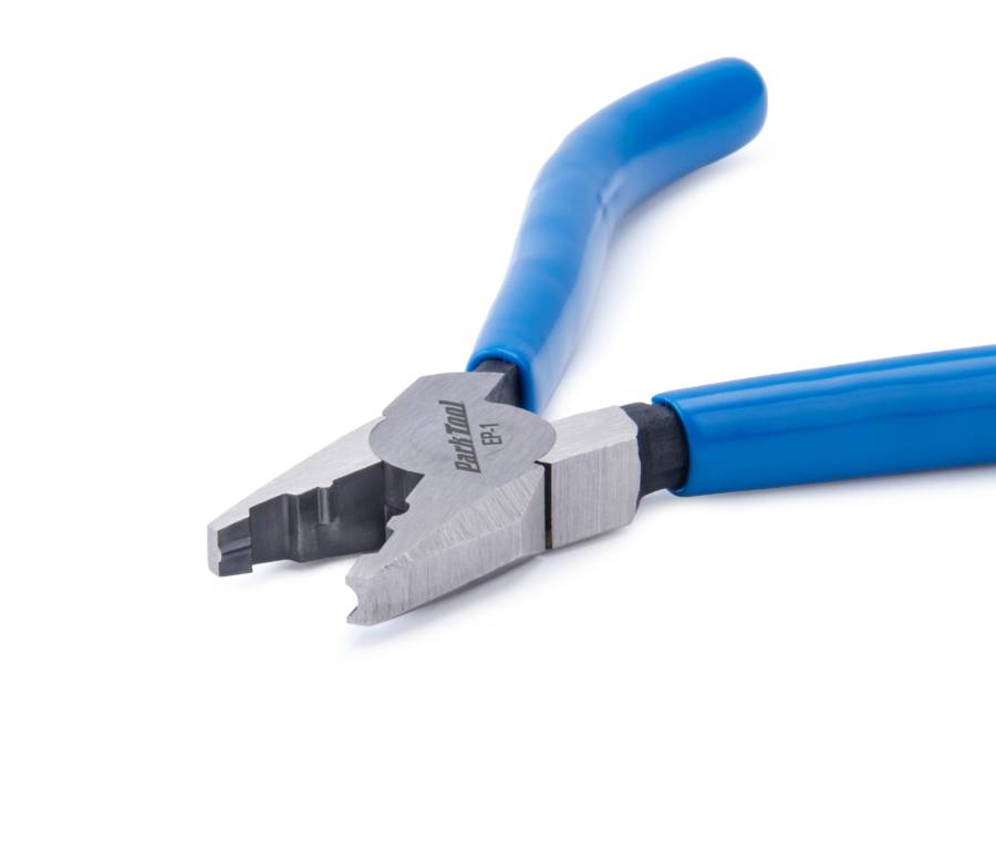

Putting end caps on using a proper crimper...
And saw guides for cutting steerers. Especially when you work out the metal edge is meant to go into a vice and everything is held steady for the cut. Bliss...
Park EP-1

I'm not really sure how you can cut the steerer wonky with one of these?
Posted : 30/06/2023 9:24 am
becasue you can put the steerer in slightly on the piss. The line is pretty much always going to be straight, but may not be at 90degs
Posted : 30/06/2023 9:36 am

I’m not really sure how you can cut the steerer wonky with one of these?
Depending on the design they don't all clamp the steerer at a perfect 90 degrees and some of them have quite a wide slot for the saw. The cut will be straight but it might not be perpendicular. None of this is an issue if you're not a tart.
I'm happy with my cheap pipe cutter. Never broken a blade and never had the bulge problem either.

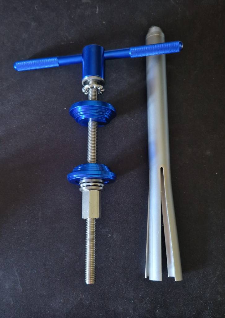

The thing I'm missing along these lines is a bearing press for hubs/ BB. I mean, a socket set can work but it feels a bit to imprecise and potentially damaging.
Posted : 30/06/2023 11:37 am
Yeah, I've an old headset press that I bodged into using as a press fit BB tool, but 1. it's a bit heavy for that, and 2. the press doesn't have the right interface to the BB bearing and I think I've probably shortened the life span of the bearings on one side by pushing against the inner face.

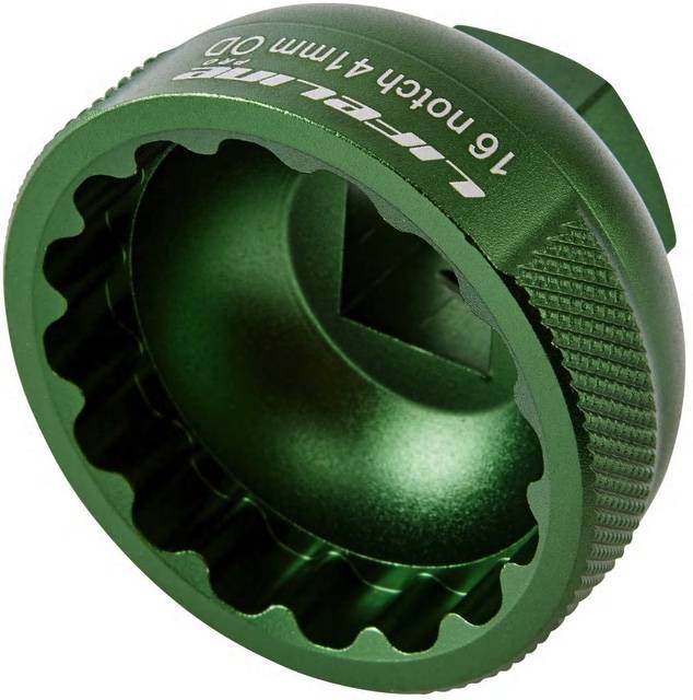

Posts: 11333
A proper socket style tool for Shimano HT2 bottom brackets is blissful if you've endured the horrid plastic insert things they supply to fit their more recent, smaller BBs. Bought the Lifeline Pro one from Wiggle and it's ace. The colour choice is, erm, 'interesting', but I quite like it.

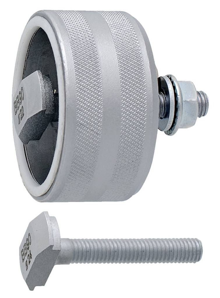

Who has the correct tool for pressfit Dub BB removal then? I certainly don’t!
Posted : 30/06/2023 7:05 pm
Posts: 427
I’ve just used a Unior PF removal tool to take out a GXP BB. Excellent bit of kit.
Unior
https://uniortools.com/eng/product/1625-2BB90-bb90-removal-tool
Not sure if the BB30 will work with a DUB?
Posted : 30/06/2023 7:18 pm
I've a couple of bearing presses and also a 12 ton workshop press, but I fit just about anything press fit into bikes with a rubber mallet, or for bearings a socket and hammer. I mean, yes you can screw it up but then you can screw anything up if you try hard enough, and at least when you're bashing things in with a hammer you're on your guard
(there's probably an actual scientific name for this but I think of it as the torque wrench effect- diyers with a first torque wrench often end up damaging stuff because as soon as they're waiting for hte click or the beep, they stop thinking about anything else)

ooh yes, that Unior looks like the sort I’ve seen on ebay. I tried a hammer and punch type one and it wouldn’t budge it. 45quid hmmm

Yup - it’s a lot, but was very smooth and effortless. The whole bashing it out with a whaling great drift doesn’t seem right (especially on a carbon frame - though guessing the frames put up with a lot worse than that).
