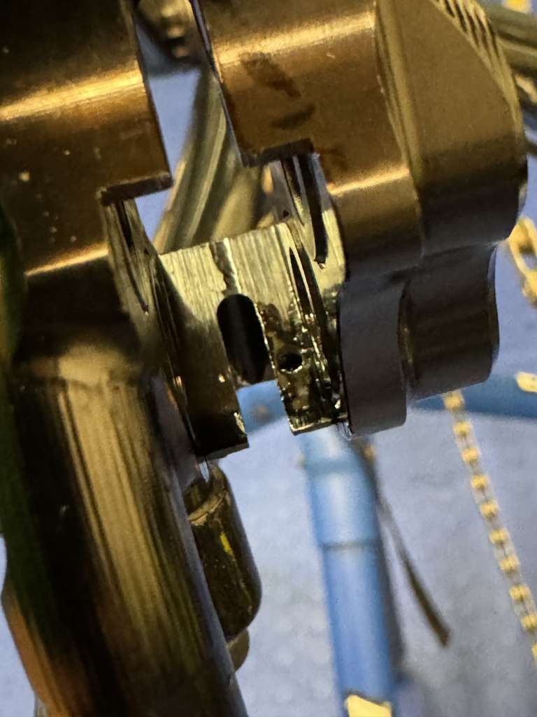

Posts: 4271
Thread resurrection!
Just bought a new RX4 rear for the winter bike I’m building. I bled it last week and have been away on holiday. Came back today to centre it and fit pads but spotted a bit of fluid in the caliper. A quick clean then a squeeze with the bleed blocks in place gave me this:
IMG_7355
Assume it’s just back to hope for a new set unless there’s something magic I can do to stop them leaking? Quite annoyed cos I keep getting bits delayed in this bike. It’s been ‘just a couple of wee bits away’ for weeks now!
Posted : 13/10/2023 9:04 pm

Posts: 10225
@stevious - is that brake fluid just loose on the caliper? I found 2 of the pistons looked let on the edges of them that touch the seals when you pumped them out a bit against the bleed blocks - the other 2 looked dry. I replaced the seals on the 2 wet ones and so far so good - the brake isn’t leaking / squealing / howling now. I’m struggling a bit to get a firm enough lever on the rear - I must still have air somewhere. I’ve followed the full instructions but going to have another go when I get a chance.
The front one has a very firm lever and bags of power but rubs noisily on the disc sometimes. I think that one needs the pistons resetting and the caliper realigning. But between them they have more than enough power so I’m just riding it as it is at the moment.
I’ve found the red pads aren’t as good in the wet as the blue ones - you need to burn the water off with a few big brake applications to get their power back after a few miles of riding in the rain / puddles. The blue ones don’t need this.
