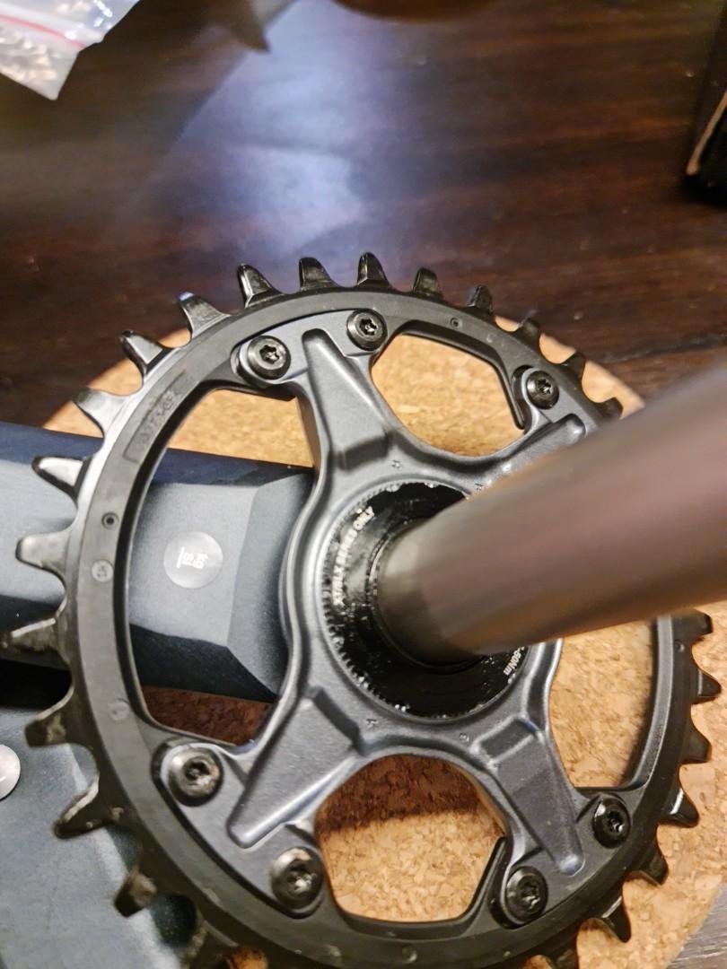

Is it the same as the one used to attach disc rotors?
Stripped down the bike thinking "yeah! Let's go ride!" but am now left with an almost functioning bike, bar the cranks.
Bugger.
Posted : 27/06/2023 10:21 am
Posts: 2597
Which crankset have you got? Are you trying to remove the chainring, or spider too?
If it looks like this then I believe they are T-30 torx key.
The rotors usually use T-25 torx keys.
S:X

Assuming you mean direct mount - you need one of these widgets...
https://www.ebay.co.uk/sch/i.html?_from=R40&_trksid=p2380057.m570.l1313&_nkw=shimano+direct+mount+tool&_sacat=0
I think I had one come with some Shimano cranks, but it was too tight to fit over the spindle.
One of these Chinese thingies does the job perfectly.
Posted : 27/06/2023 10:29 am
It’s the bottom bracket one… not that one, the smaller one that shimano sometimes provide as an insert with a new bb to fit inside the older tool. However, it is really tricky to use that insert in my experience because of the lack of access. The best I managed was to fit the insert in a vice and turn the ring against it.
Then I bought the correct tool.
Posted : 27/06/2023 10:32 am

Yeah, sorry... The spider thingy.
So the BB tool for smaller Shimano BBs...
Annoyingly I used to have one of those but don't know where it ended up. Grrr.
Posted : 27/06/2023 10:36 am

Unfortunately the torx bolts that hold the chainring to the spider have a small 'pip' in the middle, preventing use of a normal allen key. And replacement bolts don't seem to be available. Incredibly annoying as they will loosen and fall out after a while.
I had to buy a new ring and spider eventually, even though the chain ring itself was fine. Pretty poor show by Shimano.
Posted : 27/06/2023 10:37 am
I think they are security Torx? Not standard Torx

<p style="text-align: left;">Unfortunately the torx bolts that hold the chainring to the spider have a small ‘pip’ in the middle, preventing use of a normal allen key.</p>
They are torx so don't use an Allen key. A lot of torx keys/drivers have got a recess in the middle to accommodate the security pip.
Posted : 27/06/2023 10:41 am
Posts: 84
Good idea on looking for a security key, hadn't thought of that.
Still poor show by Shimano for fitting them, also replacement chainrings don't seem to be available, only ring + spider?
(I'm still bitter because of having a ride curtailed by not being able to tighten a few bolts on the trail).
Posted : 27/06/2023 10:42 am
Those bolts aren’t supposed to be removed according to Shimano, the whole ring and spider is supposed to be replaced. That’s what they told my mate when he lost some of the bolts (SLX)

Why does the ring bolt onto the spider if you can't replace the ring separately? Why did they bother with direct mount at all?

Still poor show by Shimano for fitting them, also replacement chainrings don’t seem to be available, only ring + spider?
Eldest_oab just found some aftermarket ones to get rid of the spider & chainring.
I *think* these (it is certainly black and copper splatter effect 😎 )
https://uniteco.bike/shop/drivetrain/chainrings/shimano-chainring-direct-mount/
He also considered a OneUp Switch chainring carrier - https://www.biketart.com/products/oneup-switch-chainring-carrier?variant=40808594866355

Those SLX chainrings use a T15H(hollow).
I assume it's to combine steel teeth & an alloy spider, but I don't why they don't just use a rivet.

Went to a bike shop. Asked the guy is he had the tool to swap the chain ring/spider.
He proudly told me he did, but that it was his to use and not for customers.
30€ (!!?) and he would swap it over. I asked him how much the tool was. 49.95€. I've now got the thingy to do the job myself. Steep, I know, but it won't be the first time I need it and it does disc brakes, too.
Posted : 27/06/2023 4:03 pm

In a pinch you can snap off the security pin in the middle with a small flat screwdriver.

Official tools are
TL-FC33 for older (larger, e.g. BB52) Hollowtech II BB
TL-FC37 for newer (smaller, e.g. MT800) Hollowtech II BB, or use a TL-FC25 adapter in a TL-FC33
TL-FC41 for direct mount chainrings
Not sure what does which Centerlock rotor versions.

Apparently centrelock used the older hollowtech ll tool for thru axles hubs but its a bad fit imho.

Yup my adaptor came with the cranks, tis a snug fit over spindle(or well machined),then newer bb adaptor with hollowtech tool, works a treat.Changed chainring a few times.
