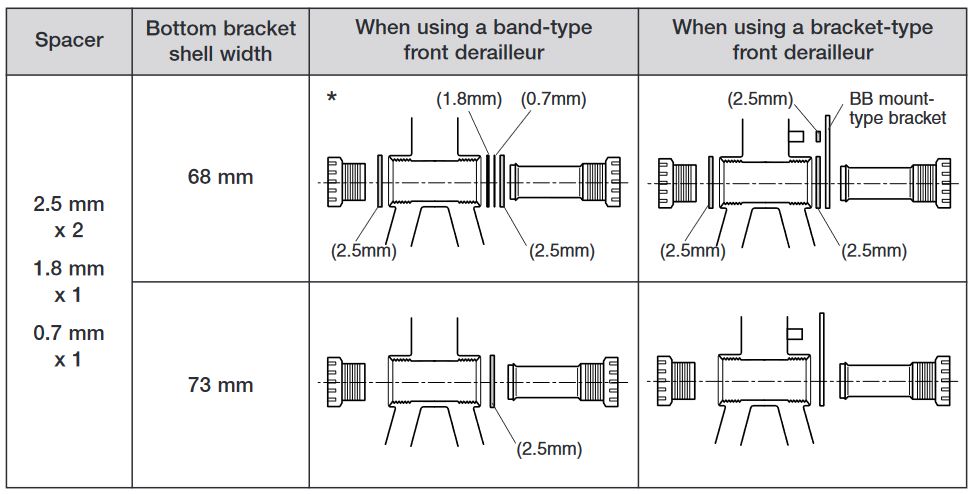

Thanks Shimano for the useless diagram, it's guaranteed to make my brain hurt every time I come to fit a new bottom bracket and realize I haven't noted which side the spacer goes.
If you can tell me which side it goes, that'd be great, or maybe supply some other examples of completely useless diagrams that cause brain ache?
Posted : 25/07/2019 9:29 pm
Insert Tab A in to Slot B.
Isn't it obvious?
Posted : 25/07/2019 9:31 pm
I can't say I'm currently orbiting it.
Posted : 25/07/2019 9:32 pm
Drive side
Posted : 25/07/2019 9:33 pm
Drive side is on the right I guess. It's obvious, but the diagram shows the frame from beneath where the drive side would be on the left?
Posts: 6581
That must be one of the most simple diagrams ever.
68 & 83mm, 1 spacer NDS, 2 spacers DS
73mm 1 spacer DS
Posted : 25/07/2019 9:34 pm

But from what projection are we looking?
Posted : 25/07/2019 9:35 pm
I'd say the diagrams are looking down on the bottom bracket so are correctly "handed".
I just put the BB in and move things around if the chainline isn't right.
Posted : 25/07/2019 9:36 pm

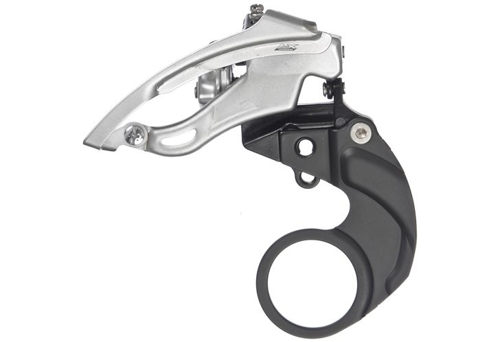

The spacer takes the place of an E-type mech. If you're not using one then it's one spacer on the drive side. If 3 are required then it's two on the drive side, one non-drive side.
Posted : 25/07/2019 9:39 pm
I've put it drive side now 😁
Posted : 25/07/2019 9:45 pm
Posts: 338
So, same amount of the same spacers for 68mm and 83mm?
Posted : 25/07/2019 9:52 pm

Why is that not a view of the BB she’ll from below? There is no seat tube indicated. The tube inside can be mounted to either side before insertion, only the cups are threaded for handedness orientation.
And if that alien offers to shake your left hand?
The universe is handed. Who knew?
Posted : 25/07/2019 10:13 pm

For my Deore BB-M52 the cup with the sleeve is drive side which makes it fairly clear (I assume that this is standard for Shimano bottom brackets).
Posted : 26/07/2019 8:01 am
Posts: 7954
The sleeve is not permanently attached to either cup so that's not a good guide.
Posted : 26/07/2019 8:40 am

That diagram is not good. When I look at the picture my brain tells me I'm looking at the bike from below. However, since I know the spacer goes on the drive side I know it must be from the top.
A diagram that requires you to already know what the diagram is supposed to be telling you is not a lot of use.
Posted : 26/07/2019 9:47 am

Agreed, diagram like that should always note the view direction or inc L and R
Posted : 26/07/2019 10:15 am
Seems straight forward to me unless you fit parts to your bike with it upside down.
Posted : 26/07/2019 10:36 am
Should always be from above, unless indicated.
Very simple diagram.
Posted : 26/07/2019 10:41 am

For the sake of adding L and R they’ve got a diagram which relies on you either having a box-fresh BB (or one which by pure luck has the tube attached to the drive side cup) or being able to figure it out (in which case you probably didn’t need the diagram anyway). Two letters and the diagram works for everyone in every situation. It’s great if it seems obvious to you, but (quite clearly) it doesn’t to everyone.
Posted : 26/07/2019 10:46 am
Because the instructions assume it's being built by a mechanic in a workstand, not bodged upside down on the floor.
Same reason the headset instructions probably don't show it being tapped in with a hammer and torques are given in numerical values not "finger tight with a small hex key".
Posted : 26/07/2019 10:51 am
Because the instructions assume it’s being built by a mechanic in a workstand, not bodged upside down on the floor.
Where's the seat tube? Assumption is the mother of all cock-ups - well home maintenance ones. An L/R or just a circle indicated in the presence of a tube would help. New bare frame, used BB bought online from here with two cups and separate tube, no reference point...
Posted : 26/07/2019 11:07 am
It's not an assumption, the drawing is an elevation, ie from above. Have you ever seen house plans, or any other plans for that matter from below? no, thought not.
Posted : 26/07/2019 11:10 am
Posts: 6762
Even if it is obvious that the diagram is being viewed from the top because it's in a workstand (I'm not 100% convinced by that logic but for the sake of argument let's say it is) that still leaves the problem that the diagram looks like it is from the bottom given the fact there is no sign of the seat tube.
It's confusing. If you already know which side the spacers go on then of course it's obvious but making a diagram that requires you to know what it is supposed to be telling you is pretty useless.
And as for the 'you'll always be fitting them fresh from the box' argument, relying on undisturbed perfect packaging is not a substitute for putting the words 'Drive side' on the diagram. It shouldn't increase ink costs significantly.
 Bez
Posts: 7371
It’s not an assumption, the drawing is an elevation, ie from above.
But you're apparently well-versed in the conventions of house plans etc.
These instructions don't just need to work for someone who's familiar with planning applications, they need to work for any old sod in a shed who's looking at a bicycle frame with a bottom bracket in their hand.
That bicycle might be in a workstand, or it might be parked upside down on the floor. That person might be an experienced cycle mechanic, or a mechanically disinclined dad who can't afford bike shop labour costs trying to fix his kid's bike.
The confused dad isn't helped by someone on the internet saying it's obvious to him. He's helped by adding two letters to the diagram.
In other words, you are making an assumption: you're assuming that whoever is reading the instructions is as familiar with diagrams and/or bottom brackets as you are.
Posted : 26/07/2019 11:16 am
Posts: 6762
It’s not an assumption, the drawing is an elevation, ie from above. Have you ever seen house plans, or any other plans for that matter from below? no, thought not.
Have you ever seen a bike viewed from above where you couldn't see the seat tube? No, thought not.
Posted : 26/07/2019 11:22 am

Have you ever seen a bike viewed from above where you couldn’t see the seat tube?
Yep. Most of the time the saddle obscures it.
Posted : 26/07/2019 11:29 am
hang on.
All these diagrams seem to show a cross section of the frame (hence no seat tube being included, threads being visible etc) but not of the actual BB.
that's just wrong
Heaven help them when they're changing pedals then!.
Perhaps you want a saddle and dropper in that elevation as well then Brucie?. 🙂
Posts: 6762
Actually, I'd settle for the words 'Drive side'. That would be simpler, wouldn't you say?
By the way, the diagram is not a 'plan'. No one is going to be using it to machine parts. It's an assembly aid so the view can be whatever makes the instructions clearest. Haynes manuals don't restrict themselves to taking pictures from directly above.
Posted : 26/07/2019 11:37 am
Fair enough, aye DS would be easier, but it's really no hard to work out. You would think... 🙂
wtf buys 2nd hand BB's btw!
Posted : 26/07/2019 11:43 am

I agree that putting L-R or Drive Side on the diagram would make sense.
If I recall correctly, the only instructions that came with my BB directed me to the Shimano website for installation instructions, which I found in the form of a number of Dealers' Manuals.
The diagram I found was:
[img] ?psid=1[/img]
The text to the right does make it possible to work out the left & right sides, but again simply orientating the diagram would be the simplest option:
"If using three 2.5mm spacers with a
band type and a bottom bracket shell
having a width of 68mm, install the
three spacers so that there are two on
the right and one on the left.
Posted : 26/07/2019 12:07 pm

BTW, the bike this BB is now sucessfully fitted to, I bought as frame only, and transferred most of the parts from my old bike to the new frame, with the addition of a few new parts. I've been riding it twice a day 5 days a week for the past six months without any mechanical issue other than wear and tear.

For those who are saying it's obvious - that's easy to say when you know,
The point that the OP is trying to make (I think) is that a simple addition to the diagram ( Such as 'L' & 'R' ) would remove all doubt.
Other examples of this are...
'Lefty loosely, righty tighty' - when tightening a bolt. What, exactly, is going left or right, FFS?
A bag of microwaveable rice, with 'this side up' printed on it. This is useless if you put that side down, without noticing. Should have been 'this side down' on the other side.
There are lots of examples, in general life, where a little bit more thought would save a load of confusion.
Posted : 26/07/2019 1:56 pm
Would be very bad. Left when right way up or inverted?
Posted : 26/07/2019 2:20 pm

To be fair, the cups have L and R marked on them so it would match up with that and they can’t* be fitted the wrong way round, but a fair point—things like showing the drivetrain on the diagram may work better.
* I realise the obvious caveat to this
Posted : 26/07/2019 2:39 pm
Italian cups in bsa frame?
Posted : 26/07/2019 2:42 pm

Clearly the view is from below, hence the uninterrupted bb shell, and just to rub it in, my 7 year old nephew just worked it out.
Posted : 26/07/2019 4:46 pm
Does he work at Halfords by any chance?
Posted : 26/07/2019 4:49 pm
 igm
Posts: 11833
I know how to fit a BB and the spacers. If I didn’t that diagram wouldn’t help.
Posted : 26/07/2019 5:10 pm
Posts: 9306
You are correct and many with tech drawing understanding would get it w/o 2nd thought, but customer-facing info that needs interpretation is a comms fail. It's a diagram that's missing key info because it was drawn by a techie or a CAD user not someone thinking with a customer's eye view.
Posted : 26/07/2019 5:13 pm

I'd always thought of the diagram as being obvious, but:
A) I guess when I first fitted an external BB, an E-type front mech was a reasonable possibility and there was a note detailing which spacer the front mech mount would take the place of. Made it a little clearer I guess. This was back in the dim and distant past before I had a workstand, so bikes usually did get
B) I have an engineering background, and am reasonably familiar with looking at technical drawings and diagrams. Which leads us nicely to...
It’s not an assumption, the drawing is an elevation, ie from above. Have you ever seen house plans, or any other plans for that matter...
I don't look at house plans all that often, but I believe they follow similar conventions to engineering drawings. For a typical engineering general arrangement drawing, an elevation would be a side view - e.g. showing levels in a pumping station, pipe routes on a skid mounted plant, or an external view of an equipment chamber sticking out of the ground. A view of something from above would usually be referred to as a plan view.
Posted : 26/07/2019 6:05 pm
Have you even seen someone with their house turned upside down on the driveway fixing the sink ?
No, thought not.

Posts: 8652
Well
Don’t all good mechanics flip the bike onto it’s handle bars and saddle for any serious work?
Posted : 26/07/2019 9:03 pm
