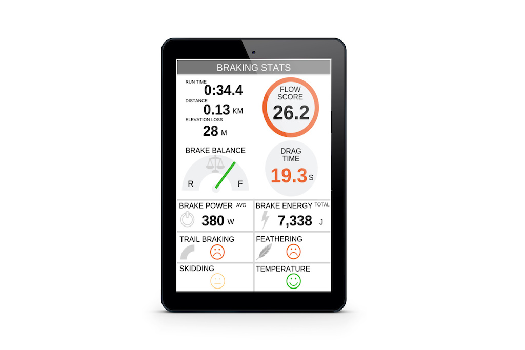

I have a bit of sympathy for TJ, physics facts about weight transference under braking, and braking force necessarily being limited by weight through the wheel is quite right. And he's got a lot a lot of experience of his own riding and watching others' that reinforces his knowledge and belief about what's happening. I think he's probably right about some people not getting the balance right between front and rear, overusing the rear when
However, in classic TJ style (sorry tj) he's not very open to considering other viewpoints and different scenarios of conditions and use that clash with ideas he's already put in the "right" and "wrong" boxes in his head.
I went looking for telemetry on braking bias and found this. I'd struggle to say he's doing it wrong, or that he's out of control, or that he's slow. EWS racer on the Rotorua National Downhill run, 90% braking with the rear. https://www.pinkbike.com/news/video-tracking-an-ews-racers-braking-and-suspension-usage.html
Not saying there are other riders who would be just as fast using more front brake, or that there are different tracks in different conditions that would require a different bias. Both of those are obviously true. I'd be very surprised if using 75% front rather than 90% rear would be a quicker way down the hill, though.
Posted : 14/07/2020 11:00 am
From nedrapier's link:
Out of all the braking Sam did while riding, 90% of his braking was with the rear brake. This was the first time I saw someone so fast riding heavily with the rear brake, but Sam mentioned it was probably due to all the deep rut and steep sections—he was just trying to maintain speed.
So this is notable for being very unusual.The rider confirmed it and explained why.
Lap after lap Sam was able to use what he had learned about his previous braking habits to make small tweaks as he went on. He cut his braking time down by 15 seconds in the end, and had shaved over 10 seconds off of his lap time! Overall modulation was down, and the average time of each braking event was 1.7 seconds--all marked improvement. Sam also took 20 points off his FlowScore, which is a braking efficiency metric we have been dialling in.
By braking less, he went faster. This is the opposite of dragging your brake all the way down the hill.
Posted : 14/07/2020 11:29 am
Here's a more representative example:
https://www.pinkbike.com/u/mtb-phd/blog/braking-down-mont-sainte-annes-notorious-la-beatrice.html
First run:
This run was not good! Had it been wet, I don't think it would have gone too well! I think the trail was a little more tricky since a post-winter line had yet to be burned in, but nevertheless it was an ugly run! There were too many points where I lightly tapped the rear brake just to check-up, and I never left off of them enough. Fortunately, the trail was relatively short--otherwise my brakes would have been at risk of overheating!
I knew that for Run 2 I need to focus more on my braking points to carry speed through the bumpy sections a bit better and thus be more smooth, so I adjusted tact for the second run:
Second run:
You can see that I spent much less time braking, had lower brake energy, higher brake power, and was able to achieve a better Flow Score. To attain these measures, I focused on braking more sharply, and looked for more places to let off the brakes. I had much less feathering on Run 2 as well. So by taking a refined approach to braking, I was able to save around 3 seconds. These few seconds are like pennies in the bank for any XC racer, and no doubt come in handy as the race goes on... and on and on!
With those narrow tyres and loose conditions though, I still had trouble finding grip and ended up trail braking too much. For runs 3-5, I was able to ride a lot smoother by braking before the turns, but to get a really good trail braking score I would be better off with grippy tyres. Unfortunately, for XC speed, sometimes riders need to neglect a bit of control and run something lighter and less knobby!
As we all watch in awe over the next week as the best riders in the world send it down this track, bear in mind how tricky it actually is. I know I'm impressed at the number of riders heaving themselves down this on non- #enduro equipment, and I think you should be too!
So, he improved by dragging the brakes less and braking later and harder, using the front brake much more than the rear brake. That's stock advice.
