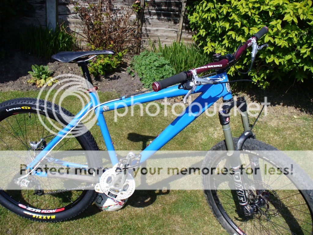

E13 SRS+ ISCG '05 with BB Adaptor
Very little noise or drag
Really easy to fit, fiddled with bb spacers and grinded off the granny tabs and was away.
X0 SS Rear mech, Cove Stiffee '04ish
[img] ?t=1272285806[/img]
