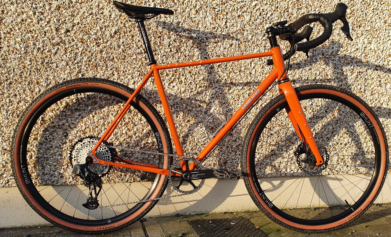

10-50 on the gravel bike, only a few hundred k on it but really impressed with shifting, the shifts seem instant and near silent, using it with a GX AXS mech. Think it looks great too, finish is really nice (boring silver and black mind) and it's as light as they say it is. Obviously can't comment on longevity yet.
