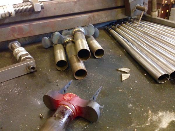

Anyway, this was me yesterday, brazing dropouts, bending blades and brazing crowns. Now today got to put the forks together.

I'm a bit late, but here's my 2p.
A custom bike can be lots of things, it can be a pretty paintjob, it can be a solution for a hard to fit person, it can be about being different.
I think it's all those things, but it's about the rider, about who you are, how much you weigh, how fit you are, where and how you ride. What you want.
I think it's not just about the building a frame, though it's important.
It's about understanding, listening.
About angles, weight distribution and pedaling style.
Translating that into a bike.
We're all unique individuals, so we all have slightly different needs and wants.
Enough words,
here's my latest, on one of my local climbs.
As much as love bikes, as vehicles, objects, craft, I think they're tools, for riding.
A custom bike should be a better tool.
It can cost more, or less, but it's not the point, the point is to ride.
The real cost of a bike, any bike, is the time we spend riding it.
For me as a builder, the real point of a custom bike is a better riding experience.
You can see [url= http://revanchebikeco.wordpress.com/ ]more[/url]
