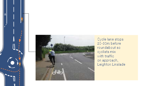

Take this, as an example;
The most dangerous point for cyclists and when those lacking confidence feel most vulnerable is junctions.
This design basically spits them out into whatever traffic is there at the worst point for their safety. They're somehow expected to find their own way to the point ont he road they should be at for a right turn. Motorists will be cutting into the left as the 'cycle lane' has ended abruptly too.
The worst thing is that by condoning this type of approach Sustrans make it ok for road engineers to introduce more of it as it's 'by the book' and approved by a 'cyclist friendly' body.
If there isn't a right and safe way to manage cyclists at a junction then maybe we have to live with it but documenting the wrong way to do it makes it worse for everyone.

wwaswas that seems like a reasonable approach to me for the type of roundabout it is dealing with: "single lane Compact/Continental roundabout with single lane approaches"
Also note that this measure isn't alone, as your screenshot presents it, they have also recommended wider cycle lanes in the uphill direction, "over-runs" to stop vehicles squeezing cyclists, zebra crossings on the approaches and traffic signals to control flow.
They even suggest replacing it entirely with traffic lights or providing segregated routes.
Really there is only so far they can go.
If they said "Every small roundabout must look like this:"
then they simply wouldn't be taken seriously.

I didn't say they should, I said that by condoning bad design that gives cyclists the illusion of being 'safe' right up to the point they actually need to be it really doesn't help. Either having cyclists segregated from traffic is a good thing (hence cycle lanes) or it isn't (cyclists 'mix with traffic'). It shouldn't change just because you're within 30 metres of the type of infrastructre that is where 75% of cyclists killed or seriously injured accidents occur.
In that specific example it looks like the roundabout was resurfaced and not repainted as the cycle lane markings cut off where the road surface changes, in any case?
Actually it does - because making cyclists feel safe is key to getting more people riding on the road, and having a cycle lane as a visual reminder to look out for cyclists helps too.
I agree that the roundabout isn't perfect - but there really isn't a cost effective solution there. What they suggest is current "best practice" which is exactly what the guide purports to be.
I'd certainly feel happier approaching that roundabout than one without any cycle provision on it - so they've got [i]something[/i] right I think.
Not even the Dutch segregate [i]everywhere[/i].

Any path that ends before the junction should be banned, It ether takes you through the junction or it has failed.
How would you engineer a path to take a cyclist through a small roundabout like that without building bridges or underpasses?
Closest I've seen is something like this:
which [url= http://cyclelondoncity.blogspot.co.uk/2013/04/transport-for-london-nails-it-full.html ]last I heard was in testing[/url] to see if British drivers could cope with it.
It's great. But I'm not sure that design is very suitable for small or mini single-lane roundabouts.

[quote=GrahamS ]Actually it does - because making cyclists feel safe is key to getting more people riding on the road, and having a cycle lane as a visual reminder to look out for cyclists helps too.
Except design like that doesn't actually make cyclists feel safe. It makes stupid road designers think it makes cyclists feel safe, but that's an entirely different thing.

[quote=GrahamS ]I agree that the roundabout isn't perfect - but there really isn't a cost effective solution there.
Except that study after study shows that Dutch solutions are cost effective if measured properly. Properly designed solutions would cost a fraction of the amount being spent on futile new road schemes (near here they're spunking millions on road widening which everybody agrees won't help - the same money could have been spent on fabulous cycling infrastructure which would have made more difference by getting people out of their cars).

In that photo:
I think stopping the lane before that roundabout is a perfectly reasonable thing to do.
I agree that busy city roundabouts need better, more involved, solutions.
But in the situation pictured, a small quiet single-lane roundabout, I think it is reasonable.
Ask yourself, if they spent a few hundred thousand digging an cycle underpass, or making a bridge, or adding traffic lights and multiple cycle lanes to that roundabout then would you actually use them?
And would you think that was a good use of the limited budget for cycling provisions?

Here's a Hembrow post regarding what to do with a roundabout like that
Cross five lanes of traffic, giving way at each one.
You'd rather do that than just go around that small roundabout like a car?

[quote=GrahamS ]Cross five lanes of traffic, giving way at each one.
Aha!
[quote=David Hembrow]Some may quibble at having to give way at the crossing of the other roads joining the roundabout itself.
He goes on to point out:
However, consider that if I didn't give way where I do in the video, I'd otherwise have done so to the same car on the roundabout itself.
Though more pertinent to your "giving way at 5 lanes of traffic"
The only way to have to give way twice is to ride around the roundabout in order to make a video.
...which I think is the only way to give way to 5 lanes.
In reality if you applied that solution to the roundabout pictured in the Sustrans doc, you'd end up with one route with no give ways (1 less than Sustrans) and one route with one give way (the same as at present) from the pictured orange dashed lines.
I am admittedly a big Hembrow fan - the thing is I do see no reason why his* ideas couldn't be implemented here, the only thing which is stopping them is a lack of will. In plenty of cases it would actually be no more expensive to do it properly.

[quote=GrahamS ]New Sustrans blog post about the handbook and comparing/contrasting it to the "Making Space for Cycling" and Cambridge Cycling Campaign guidance.

I accept we can't have it all now and something is better then nothing.
But! there has to be a minimum standard where they can so "no [council] that's just awful and not suitable for bikes" ime the part of the national route near me should fall into that category.
GrahamS's example photo above would be a delight to cycle on compared to some of the carp I commute on. Yes it's not Dutch but that'd be good enough in my book. I don't agree with the bad advice though. I doubt the proper advice would cost any more to produce.
Posted : 02/05/2014 1:47 pm

we could learn from the Dutch, but something is stopping us
See that weird looking roundabout on page 1:
That is a Dutch-style roundabout being tested by Transport for London at the Transport Research Laboratory in Bracknell.
That knowledge [i]is[/i] filtering through. There are some people in transport that understand it well.
But the public and political will just isn't there. Yet.
