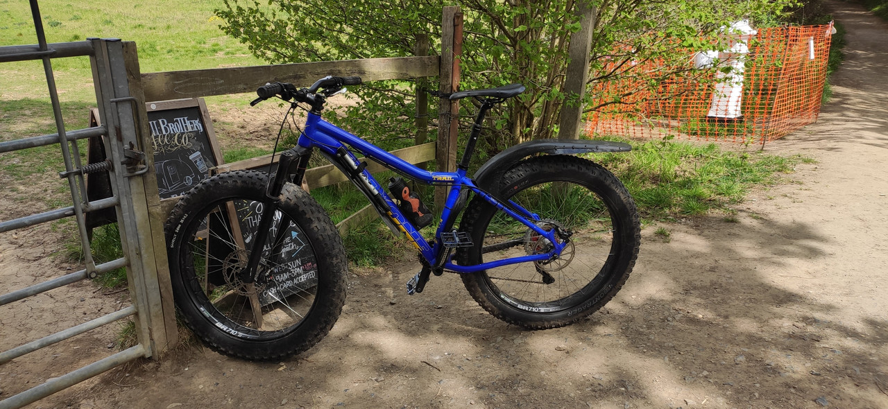

If we are doing pictures..here's mine from today.Essential even on a fatty.
null
Posted : 25/04/2022 5:21 pm
