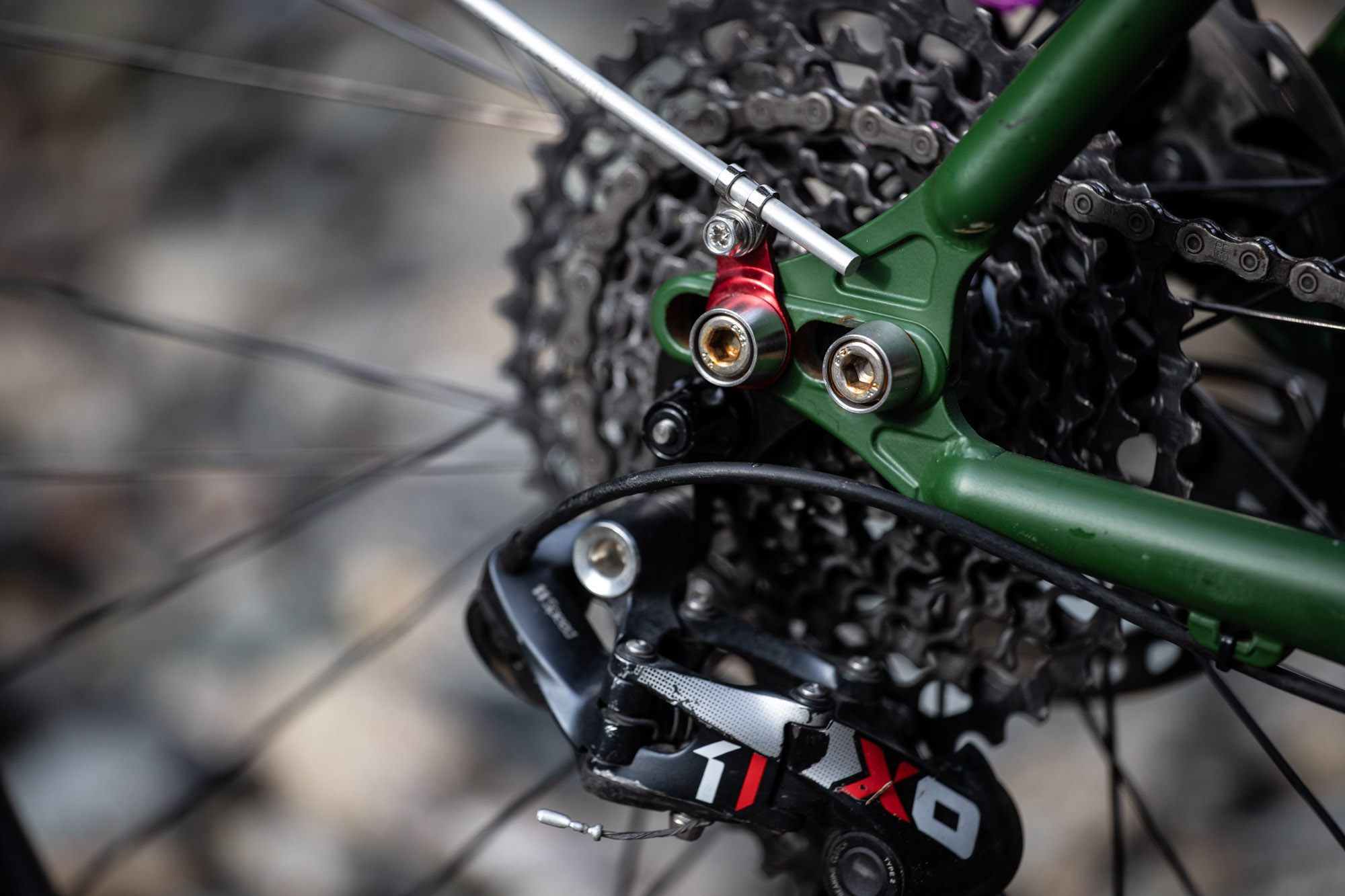

Special axle is far from ideal; expensive and PITA for wheel removal.
Found this use of a drilled-out axle runner attached to the sliding dropout bolts, they're supposed to be for mudguards only though (Axiom, PDW)
axle runner

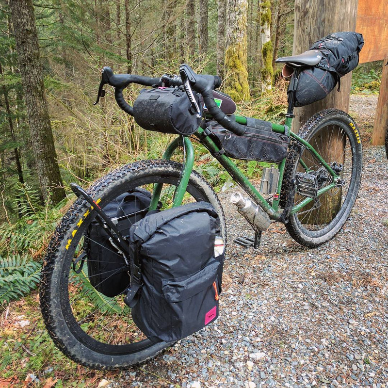

This is turning into a load of hassle so I might just go for a rack on the front only:
front
