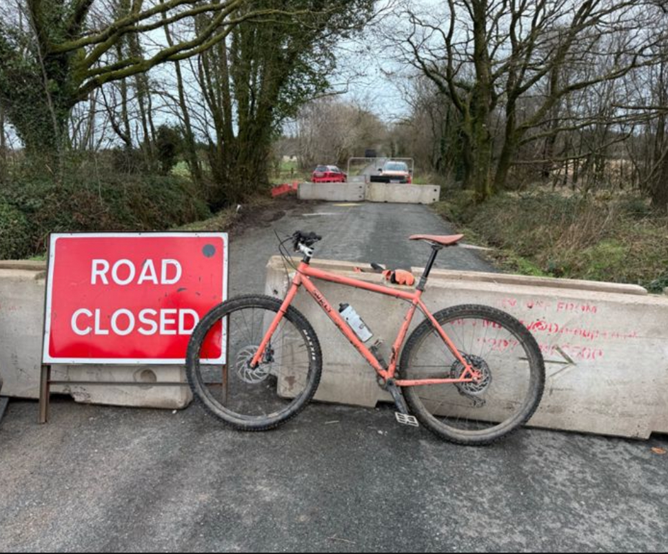

I have one, 2023 (?) salmon pink. It's heavy but you dont really notice it. I use it for all rides from home and plan to do some bikepacking with it when the yellow orb appears in the sky again.
