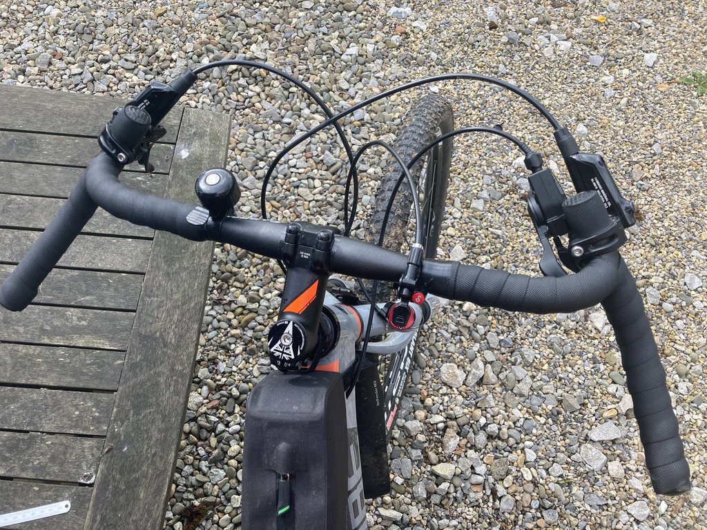

I have the Zniino carbon copies off Ali Ex.
I chose them because they had plenty of selling history and reviews.
I have no issue with the quality they are great.
I have not died yet but I will post here and let you know if I do
I have put them on an old XC bike and they have taken some abuse but suspension will smooth out knocks a bit I guess.
People say that they wouldn't buy chinese carbon but from all of my searching it does not seem to present an increased risk. I do not find many verifiable issues. And go for sellers with reviews
Mine are 460mm at the hoods and that works great for me for road positions and good control downhill.
I have an integrated brake/shifter on the right which is quite compact but I find riding on the tops, hoods and drops all very confy.
https://i.postimg.cc/bNWFq5wM/C3-A48-C77-AFEE-49-C3-ADB6-73049-E39-F5-EA.jpg
It is possible to shift and brake from the hoods.
https://i.postimg.cc/SsvTKXB6/B7354171-1-F78-485-C-BE5-E-C29-BE807790-F.jpg

@dufresneorama the drops are 17cm you could put some of the spare grip at the top
A normal length of bar tape is more than enough for the whole bars.
@shedbrewed Internal width on drops and hoods is 18.5mm
These are 46cm at the hoods
https://i.postimg.cc/yxvzCQgr/C084-D2-CF-08-CA-4-DAF-8-AF7-8-BD8-E989-A355.jpg
