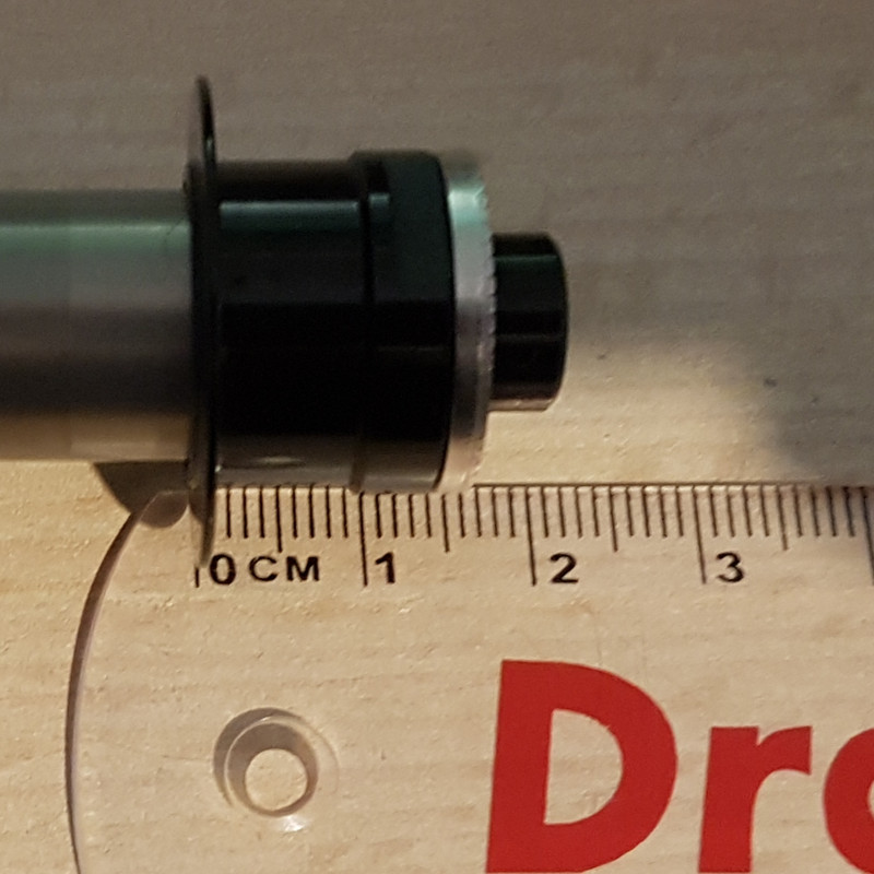

Posts: 1553
I have an unused RD010 135mm Conversion Kit QR and when I measure over the 'flats' it is 135mm.
Endcap is different to the one you show by not have an o-ring seal (guessing it was for a road wheelset). What is the length of you endcap for comparison. If this fits you are welcome to the parts.

Posts: 1553
How's this look @nre ...

 nre
Posts: 460
That looks perfect @vmgscot, awesome!
