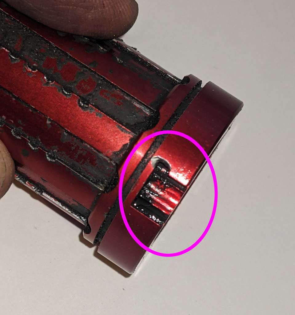

Then, while trying to get the old ones out (stuck fast, going to have to resort to a bearing puller), I spotted this.
Looks like a bit of the freehub body around the slot for the pawls has flaked off. Probably going to mean the pawl will always be a bit cockeyed now.
I think this means the freehub is fubar.

Posts: 10225
Can’t you just buy the replacement freehub body for £35?

Posts: 7076
Yes, could do, but it will presumably have a reasonable chance of failing the same way, at some unknown point in time.

Posts: 10225
But it lasted 4 years with no maintenance at all on it? Maybe the pawls / pawl springs got gummed up and that led to the failure?

Posts: 7076
Not sure it's lack of maintenance - I suspect it's a metallurgy problem. I had another SS hub where the flange cracked, so just a bit nervous about it.
Anyway, Superstar have a 30% sale on, so for £25 I can have a new freehub, which means I can get to work in January without spending Christmas with the wheel jig (I already have enough other things to do).
To answer my earlier question, Bitex MTR12 results in same spoke dimensions so would have been a good option, and looks quite nice. I think I need to plan on building another rear wheel and keep the SS as a spare.

Posts: 7076
Followup - I've replaced freehub, hub bearings and for good measure, the axle. Seems fine now.
I suspect the design of the freehub means it has a limited life expectancy because the material on the outside of the slots is so thin. But for now it's going again. Might do a hub swap sometime when I'm bored.
