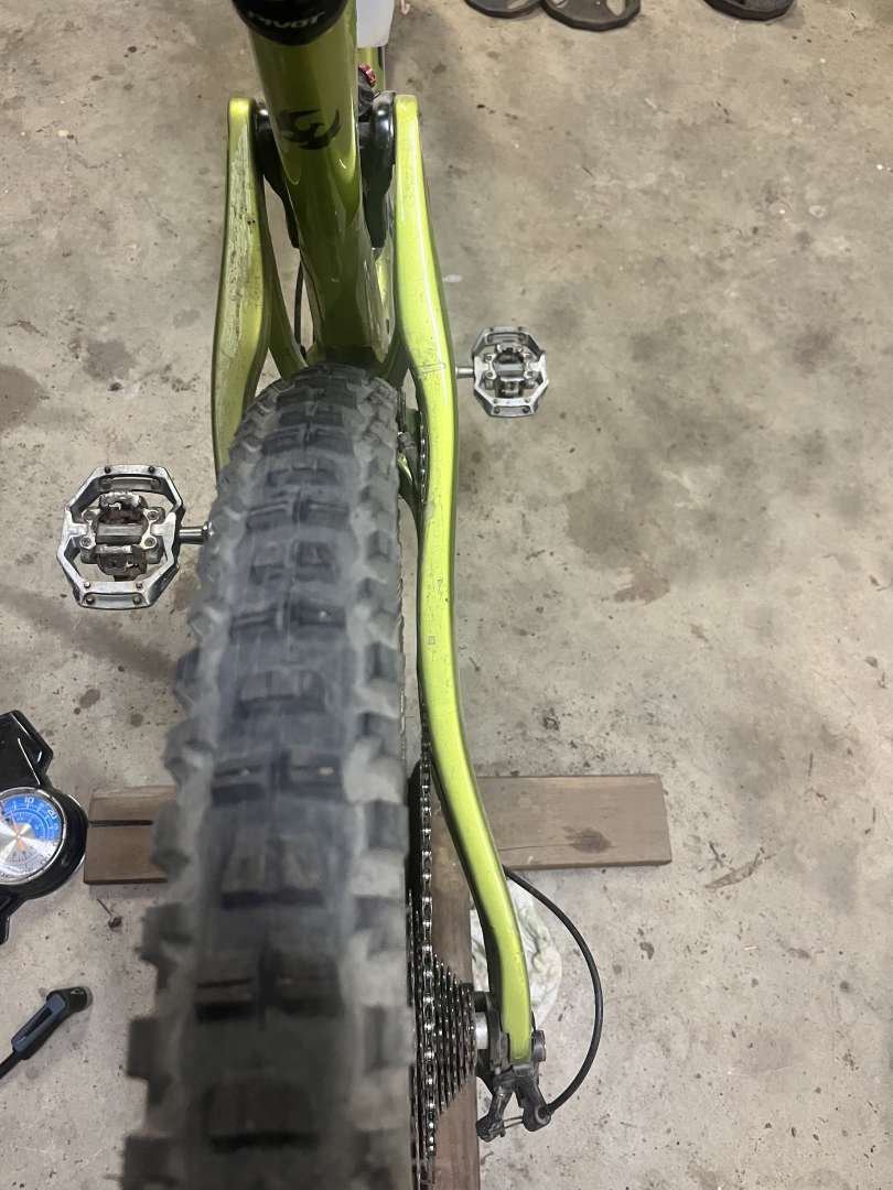

I don't get any heel rub with SB pivot but I do with Santa Cruz Boost.
The way Pivot deals with SB heel rub.
Posted : 27/10/2025 8:58 am
