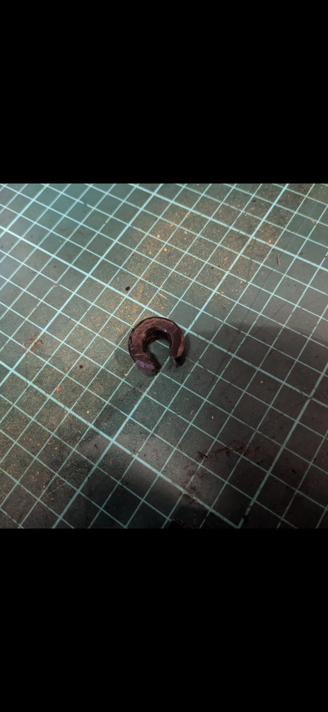

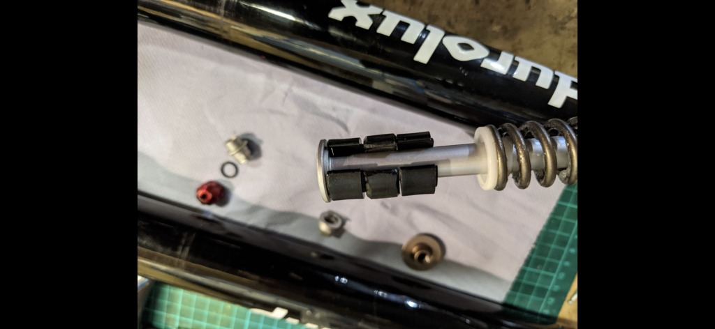

I couldn't get hold of any so ended up making my own.
  • 20mm diameter nylon rod
  • Cut into 10mm 'coins'
  • Drill hole in centre
  • Saw notch in the side to make a C shape
https://www.ebay.co.uk/itm/271969643109?mkcid=16&mkevt=1&mkrid=711-127632-2357-0&ssspo=3a-EWgVIRG2&sssrc=4429486&ssuid=P8od238_T6e&var=570797479169&widget_ver=artemis&media=COPY
Posted : 16/01/2024 12:36 pm
Posts: 408
Screenshot_20240116-114121Screenshot_20240116-114150
Posted : 16/01/2024 12:43 pm

They look mightily similar to the Cane Creek ones, shaft dia might be different though.
