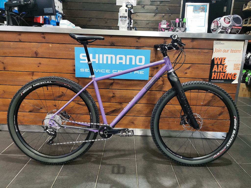

Posts: 1826
I really like my Fairlight Holt. Bought it for bikepacking and XC duties and to replace a gravel bike after realising drop bars and gravel bikes are silly.
Fairlight have just released a new 2.0 version which gets rid of the 27.2 post in favour of a 30.9 which put lots of people off the original. It's also got redesigned dropouts so you can use T-Type derailleurs. I've got the original and am really happy with it, It's a great frame and builds pretty light, plus the purple is nice!
Plus their design notes pdf is a good read!
