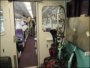

I'd have thought minimum faff, maximum packing density would be something like that - perhaps using the (old) design from Scotrail west coast trains as a starting point? . - sorry not a great pic but I'm sure they used to squeeze 6? bikes in a small space rather efficiently?
Trying to get my head around the immense amount of days you’d need to even start paying for a van like that. Ouch
Are you thinking of operating commercially? That's where the insurance will presumably get very expensive. Worth considering also that a minibus+trailer is relatively easy to replace if you get a mechanical and its off the road for a few weeks or it reaches end of life plus relatively standard for selling on - whereas something that's been custom built will be harder to sell.
I'm not sure that a huge minicoach is going to be that much easier to drive/park than a smaller van and decent trailer.
