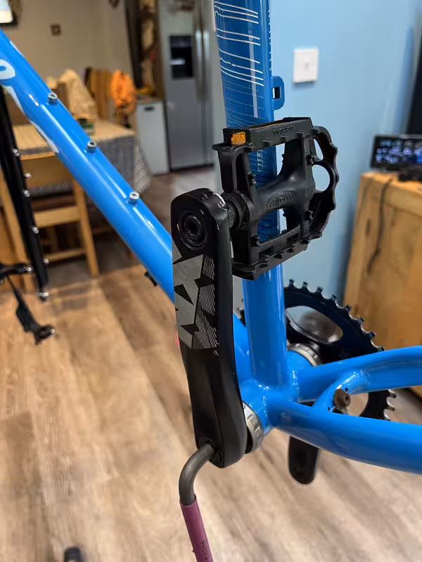

Ever come up against these tight self-extractor style NX/other SRAM crank? Usual fix is to get a willing helper to sit on the bike and anchor the pedals while you chuff at it with an 8mm key and extender.
Well, my gift to the world today is this. Yes, that’s an old plastic pedal inserted and threaded on the reverse of the nds crank arm, acting as a brake on the seat tube. I am not sure but believe I have just invented this.
Works a treat.

My go to is to put the bike upside down under my garage table (which has 4 vices and a tools chest weighing it down), which is at a convenient height it catches the pedal and stops the crank spinning, then getting a breaker bar on the bolt.

I just have the drive side pedal at 9 o clock (i.e backwards), and have a car jack under the pedal, and then use an 8mm Allen key and an old Brompton seatpost as a lever.

I can see that removing paint or worse...although I knock myself out, I'll stick to the pedal and Allen key getting pushed down very hard - bloody hurts and I do seem to be out or stunned for 5-10 seconds, but it gets the crank off... thankfully only had to do it twice, but both times I've skelp my head off the top tube when it finally let go!

Similarly, for getting tight pedals off, use a big workshop-style allen key and just rotate the cranks until the plastic body hits the seat tube. Easy!
Posted : 07/10/2024 10:10 am
Posts: 173
Although on reflection, every set of SRAM cranks I've used this trick on, the self-extracting bolt (and hence the allen key) are on the drive side, so I'd have the reversed pedal up against the bottom of the down tube.

Thanks Stevo, guess there's nothing new under the sun. I'll withdraw my patent request 🙂 and as you say, downtube could also be used.

Yay, just had to remove the dub cranks to fit a new preload ring… reversed pedal under the downtube, seatpost for leaverage on the allen key. Worked a treat! Amusing thing was, the allen key sockets and breaker bar I ordered arrived just as I finished and put the bike back together ?
