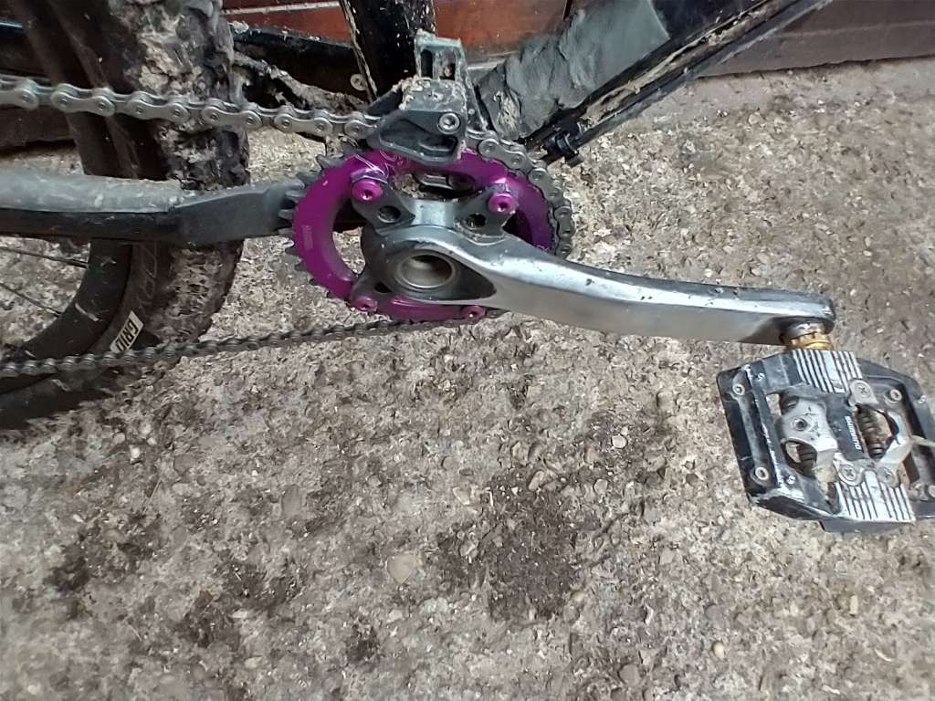

IMG_20210711_133432900_HDRI stripped the anodising off the front my xtr Shimano cranks.
The gray colour came off very quickly where my shoes rubbed.
It was harder than I expected using a Dremel and metal polish.
I bought some drain cleaner to strip the finish chemically, but then used it to clean the drains!
The Shined aluminium promptly got scratched again, and quite a lot of the effort of polishing it was wasted. It looks better than part silver and part Gray rub marks.
I was going to do the other MTBs cranks as well, but decided against it. They are still grey/ silver where my shoes have rubbed them.
