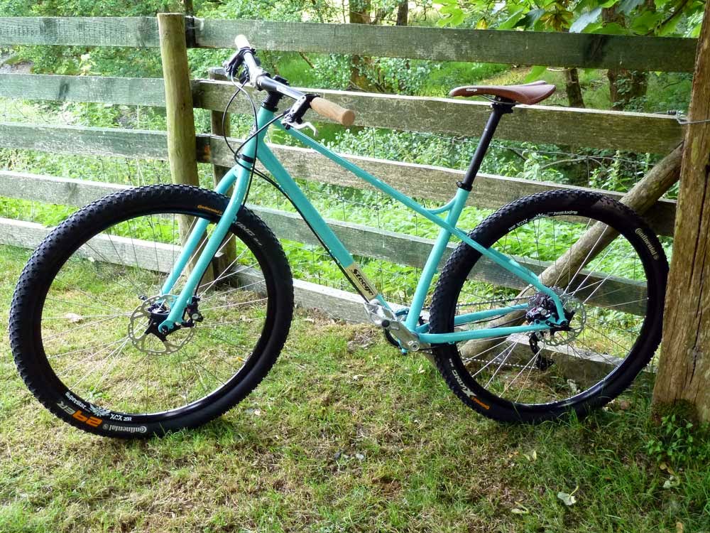

Built.
[url= https://farm3.staticflickr.com/2938/14568900188_2b90a82ea4_z.jp g" target="_blank">https://farm3.staticflickr.com/2938/14568900188_2b90a82ea4_z.jp g"/> [/img][/url][url= https://flic.kr/p/ocpqsh ]Stooge build day (5)[/url] by [url= https://www.flickr.com/people// ]placid casual[/url], on Flickr
Purple Hope, XT/Zee and Thomson bits (the stem hasn't arrived yet so has a Crank Bros temporarily fitted) with Velocity Dually rims. I still need to shorten hoses, but maybe not if I fit the Jones bars.
Plenty more pictures here: https://www.flickr.com/photos/placid_casual/sets/72157644970654521

This morning my frameset arrived from CTBM ............some quick building...........first ride on my local trail............and the first pictures of a (somewhat dusty) Dutch Stooge.
Few things are temporary; I am waiting for a polished set-back setpost......the DIY chainguide (made from an old derraileur) will be replaced by a N-gear jumpstop........the 8sp Sachs gripshifter and STX-RC rear derraileur will probable be upgraded to 9sp ......and I need to swap my Mach1 rearwheel to a Blunt35...............but the first ride was FUN.
First impressions: indeed very comfortable for a rigid 29er, feels pretty fast and manouvrable but also steady at higher speeds. I have to get used to the fact you need more body-movement for fast tight curves (slack angle?) ......but it runs as if on rails!
Posted : 31/07/2014 8:25 pm
That's lovely, I thought I preferred the purple colour but I'm not sure now. It's worth tinkering with the tyre pressure on Surly Knards, I've found the sweet spot to be around 10-11psi on the front (fine at that pressure or even a little lower with wide rims and tubes).
Posted : 31/07/2014 9:13 pm

Posts: 941
Just finished my build... Hope I'm not too late to the party..
Singlespeed
Hope Pro 2 SS / 9mm bolt in mod front
Dually's on chunky monkey rear (5mm clearance at seat stays)/knard front.
Hope headset, BB, stem,pedals
Tech 3 E4 brakes and floaters.
Middleburn Uno 32 crankset.
Thompson elite post
Flux saddle, may switch for brooks cambium.
On one OG bars feel good so far may try a flat bar...
Posted : 08/08/2014 6:26 pm
Posts: 3
Nice - first SS I've seen
You prefer a straight seatpost?
How does she ride?
Posted : 08/08/2014 8:30 pm

Posts: 941
bonesetter - Member
How does she ride?
Straight post yeah I'm 5'11" thought the reach with a 50mm stem and old man bars would be about right, found this Thompson post and thought I'd give it a go.
After the first ride I'm happy with my position on the bike.. Saddle is right back on the rails mind.
It rides really well I love it infact I know NBS n all that but it's a proper grinner for sure. surprisingly comfortable and great handling too its no regular 29er, 29ers really ain't my thing at all but this thing is something else really nimble feels so much lighter than it is, effortlessly bunny hopping fallen logs n shit (literally) yet still retaining the usual wagon wheeler feel of straight line barrelling through ruts etc.
Performed well through the country lanes too, tyres weren't as draggy as expected and was keeping up with the (leisurely) roadies as we passed I heard mutterings of "mumble....a Jones or something or other "
Yep great bike suits me to a T and looks sweet as too.
Posted : 09/08/2014 2:12 pm
