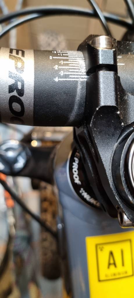

Just swapped a beefy Nukeproof Neutron 50mm for an On One El Guapo 35mm, which has a narrower clamp and looks a little weedy compared to the original.
Does anyone notice stiff stems with wider clamps?

New stem a fair bit narrower than the previous.
Posted : 28/06/2023 7:48 am

Incorrect. They're cool. I suspect the clamp width is a big factor in how well it holds the bars and perceived stiffness. I'll let you know when I've ridden the narrower one.

I think clamp width could be important. You can see from this pic that the anodising has rubbed away already where the edge of old clamp was, so that's clearly where all the force was going.
