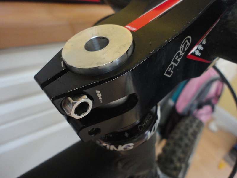

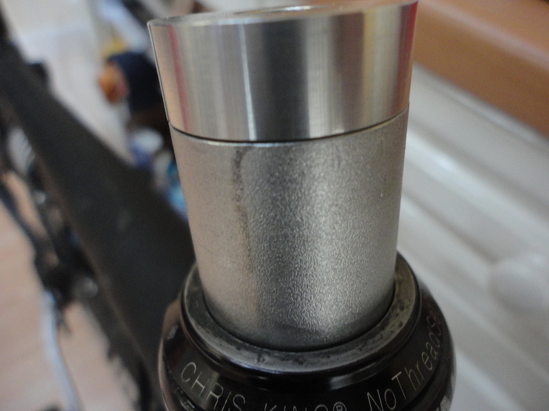

I did this, friction fit, allowed me to tighten the top bolt without pinching it closed. worked a treat.
[img] http://ep1.pinkbike.org/p4pb11369801/p4pb11369801.jpg [/img][img] http://ep1.pinkbike.org/p4pb11369797/p4pb11369797.jp g" target="_blank">http://ep1.pinkbike.org/p4pb11369801/p4pb11369801.jpg [/img][img] http://ep1.pinkbike.org/p4pb11369797/p4pb11369797.jp g"/> [/img]
Posted : 23/03/2015 11:26 pm
Sorry iffoverload what have you used in there? I can't quite work out what you've done or how!?
Posted : 24/03/2015 12:00 am
Posts: 497
I turned a small piece of aluminium down to be a friction fit into the steerer and extend about 12mm above it effectively extending the steerer by about 1/2"
the outside diameter of the top part is equal to that of the extenal steerer, and the lower a tight press fit into the internal part.
the last photo shows the stem fitted and tightened, without the small extender the upper clam used to pinch shut before it was properly torqued to 8Nm
[u]
not shown is the required 5mm spacer and top cap to preload the bearings.[/u]
I prefer to set up the stem so that the steerer is always slightly above to reduce any chance of the stem trying to "walk" up the steerer and place stress on the preload bolt/starnut.
Posted : 24/03/2015 11:21 am
Posts: 9
How is that going to help anything other than preventing the stemp clamp being overstressed?
The bung isn't structural is it?
Unless Im not understanding what you've done properly?
Posted : 24/03/2015 12:13 pm
Posts: 497
not sure what you mean?
it is an extension to the steerer as it was a touch too short for a new frame. re the OP "steerer too short"
you can do the same thing with a more depth and height and use a proper epoxy to bond it into the steerer as well, but you need to do that very carefully or obviously it is stupidly dangerous, especially on an off road bike.
[img] http://ep1.pinkbike.org/p4pb11369798/p4pb11369798.jp g" target="_blank">http://ep1.pinkbike.org/p4pb11369798/p4pb11369798.jp g"/> [/img]
