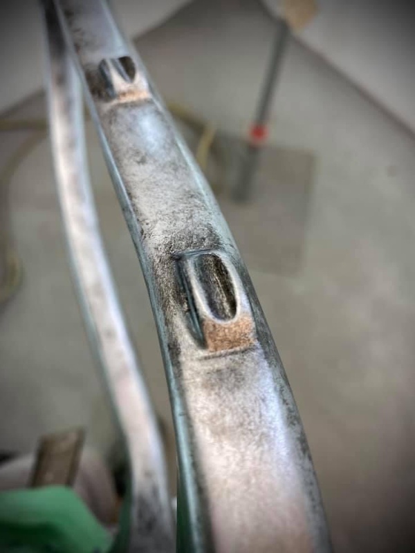

@LAT, afraid not, it’s a carbon frame made to look like it’s made of metal. Here’s a teaser.
Won’t be to everyone’s taste, but I think it looks ace 😊, yeah it will have the string wheels.
