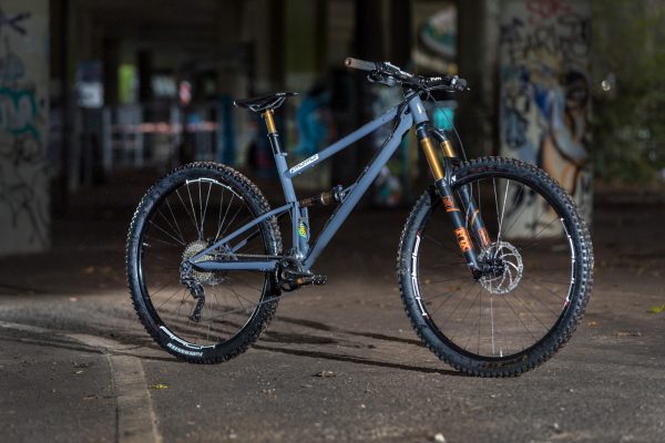

I looooooove my Reynolds 853 steel tube Stanton Slackline.
Sorted geometry means it goes round corners like nothing else, confident on everything.
Small thing like when small stones flick up on the down tube it sings with a sweet 'piiiing'.
Posted : 12/12/2016 6:55 pm
