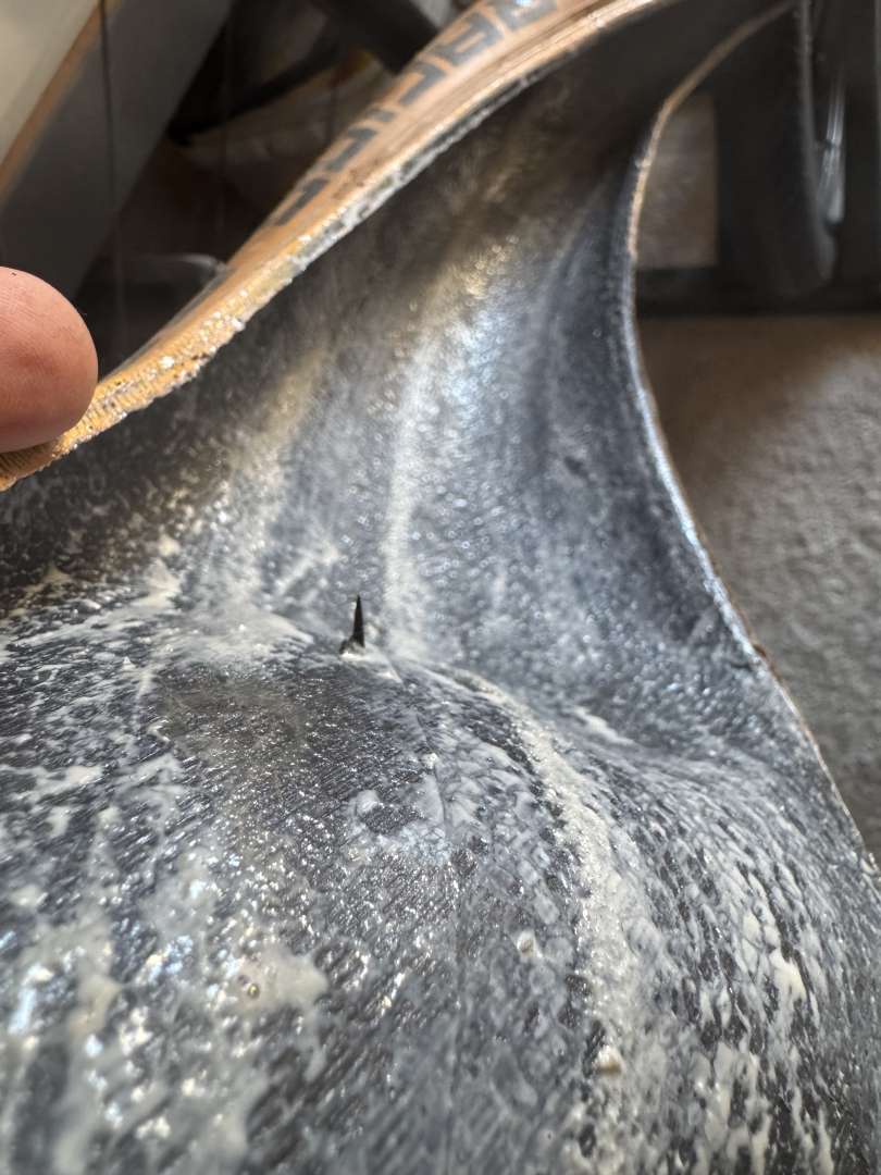

Having a nightmare start to the season on my 'summer' gravel bike, mostly down to tubeless faff.
Having removed the winter tyres and swapped for summer tyres (same brand, same carcass, same tyres I ran last summer) I first had issues with taping the rim (which I also moaned about on here). Clearly my taping was at fault, but the sealant did nothing except eventually show me how the air was getting out (by the trail of sealant under a wrinkle in the tape leading to the valve hole). So the sealant failed to seal the very small gap formed between two layers of tape pinched shut in part by the valve core and the tyre beads. Not a great start...
Also in the past I've had punctures at the bead not seal at all, although I've forgiven the sealant for that one as it's a tricky place to get the sealant to 'pool', despite lots of shoogling of wheels trailside.
Final issue was a deflated tyre at the weekend, which on closer inspection was a good old fashioned Haw-thorne in the sidewall. I was surprised the sealant hadn't coped but pulled the thorn out and re-inflated, which held for 10 minutes on my next ride but then needed plugged and re-inflated. This held until I got home and deflated again. I've pumped up the tyre and left sitting with the plugged hole at the lowest point and just came back to a pull of sealant which has somehow managed to get through the tiny hole (you couldn't even see it) without sealing! Cue Basil Fawlty what's the point etc. etc. ranting.
Presumably if I want to swap to something better I need to clean all the old stuff off the inside of the tyre? Or can I just ditch the Stans and pour in some Orange Seal or something? Not meaning to be controversial but given that every time I've actually punctured, the tubeless system has let me down, I'm actually thinking about going back to tubes again 🙄

Survivor bias (or what's the opposite of that?) you only notice it when it fails
I did wonder, but then there has been no evidence of punctures it has actually sealed, I keep looking for thorns or cuts in the tread (inside and out) but nothing. Testament to the construction of Vittoria tyres maybe.
Granted the loose chunks of foam insert floating around in the pool of sealant when I last demounted the tyres showed where the inserts had maybe done their job, but most likely when I was riding on a slow leak due to Stans not sealing 😂

I should have mentioned that the thorn puncture was also on the sidewall as opposed to on the tread, so maybe I've just been unlucky that all my punctures have been sidewall where the sealant doesn't repeatedly flow over ..

Well on the evidence above I'll have to put it down to being a sidewall puncture, rather than a Stans failure. I came out to a glassy little bubble of superglue hanging off the side of the tyre with a dribble of sealant inside (I accidentally popped it before I thought to take a pic) so have zero faith in it holding on the trail.
Having just got the rear wheel sorted I'll now be taking front tyre off to patch now 🙄
Joking aside I'm hoping to fit wider tyres later this year, almost tempted to go back to latex tubes to try and objectively compare number of punctures vs. hassle...

I was taking tyres off today and wiping up the Stans residue. Front tyre had a small thorn and rear had something resembling a hypodermic needle. Was right through a tyre  knob and protruding a good 8mm. God knows how long they’ve been in there, but both would have been a puncture repair on the trail. Neither had resulted in a noticeable pressure loss when out riding.
