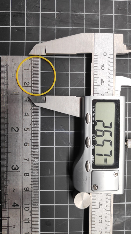

Had a go at measuring the o-ring, but it's pretty awkward. I'd say it's 26mm outer diameter, and 1mm thick, but I could be off by a bit.

Does this help? It's quite hard to get it round. It's about 0.8mm, but cos it's squidgy it's hard to get a great measurement.
oring
If you do get a working replacement then post back. Getting the official measurements could be useful.

I think I'll give a generic 24 internal x 1 thick a go. It's being used inside for the next few months so I've got time to play with sizes to ensure something fits.
