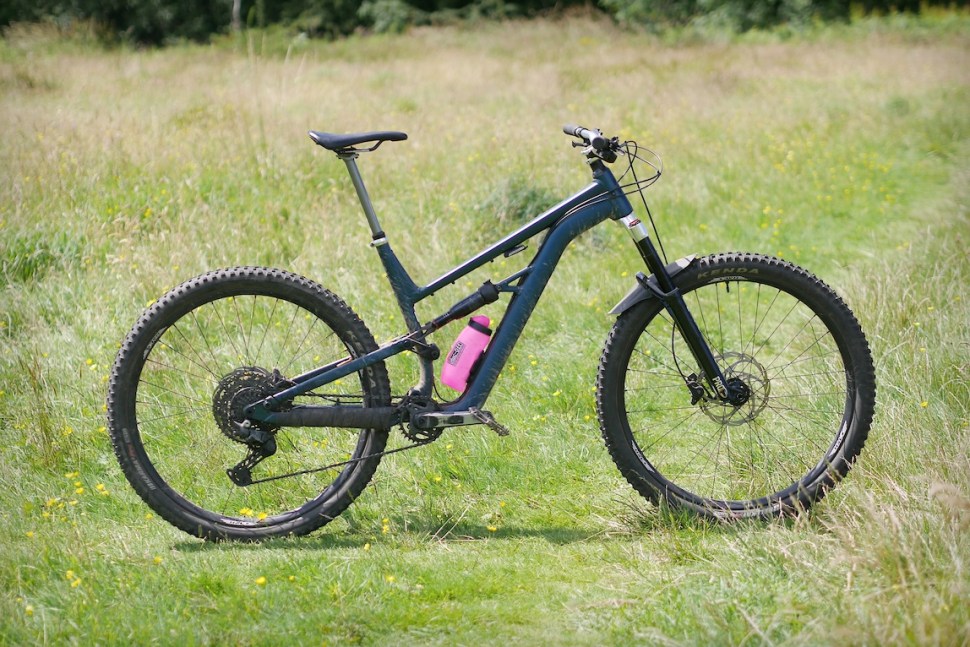

Just how far can you upgrade a so-called budget bike?

I guess the question is "why?"
What are you looking for it to do that it couldn't do before and have you measured the 'improvements' in any way.
E.G have you tried the old wheels and new tyres, or new wheels and old tyres...
Does the shock make it faster ?
Can you brake harder?
We've all been there and done the same, but honestly, you'd have arguably bought a better bike for less money if spending £2000 on an Ebay Santa Cruz Hightower.

Those 400-series brakes are surprisingly good eh?
I think it's a nice idea, making the kind of upgrades a new-ish rider might. Maybe share more about what it's like to ride before/after though?
Dunno much about wider range 10sp cassettes BTW, you might want to drop to a 28t ring when you change to 165mm cranks. That should be fine with a 48t biggest cog.

So where are you at weight wise compared to the original bike?

Keep the comments coming. All useful. I'll be doing another update to Project Bossnut once it's 'finished' which will hopefully address most of the things mentioned so far. I'm currently 73kg or thereabouts depending on Asda's craft ale deals.

to reduce the amount of dead-throw
Really? How does that work beyond the first ride?

Rear shock upgrade...?
i'd stick a Manitou Mara inline on it.. best inline air shock ive ever used!
It doesn't on it's own, unless your brakes are over-filled and working like a set closed system brakes form the 90's.
But depending on the pad compound the coefficient of friction may decrease with temperature, so you squeeze it with less force, and thus less travel for the same level of braking. Likewise if the rotor has higher friction.
