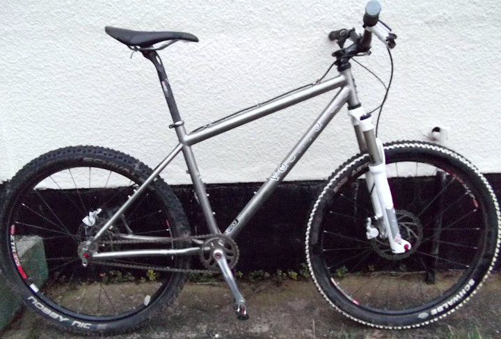

(for some reason rise on the bars look huge in the photo but they're not)
First outing today in the quantocks. Running a 32:16. Think i needed a wider bar for the climbs but just about managed to get up everything. Felt great on the descents, first time i'd ridden a titanium hardtail before and I know what people mean about the feeling (everything was a straight swap from a scandium sobo)
Posted : 15/01/2011 4:34 pm
Chains far too slack.
Posted : 15/01/2011 5:13 pm
Posts: 4336
I know.. needs sorting out after todays first ride
Kept checking it on the ride and everyone else kept saying "it's okay.. leave it alone.. it's not skipping or falling off"
Posted : 15/01/2011 5:14 pm
