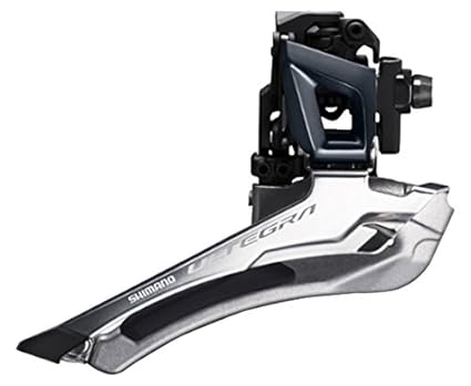

Sounds like you need one of these...
And a double chainset obvs.
