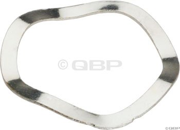

Posts: 1781
It transpires I was missing a "Wave Washer for GXP to PressFit Adapter" which wasn't well explained in the exploded diagram.
It looks like this:
Big thanks to Hargroves for sorting me out and giving me some good maintenance advice (mostly, do some :mrgreen: )
