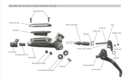

I removed the lever as it was sticking (hand to sand the piston) reassembled and bled the system.
I’ve ended up with a little rubber o ring spare, I can’t be sure where it came from but after bleeding, the brakes work for about 10 presses and gradually the lever ends up right back against the handle bars and not actuating the caliper pistons
Weirdly no fluid seems to leek out
Any ideas?
Help!
Thanks

Thanks
I didn’t realise they did exploded views like that, found the same for the caliper and it’s the breed screw o ring I’ve found... probably why it’s letting air in then!
