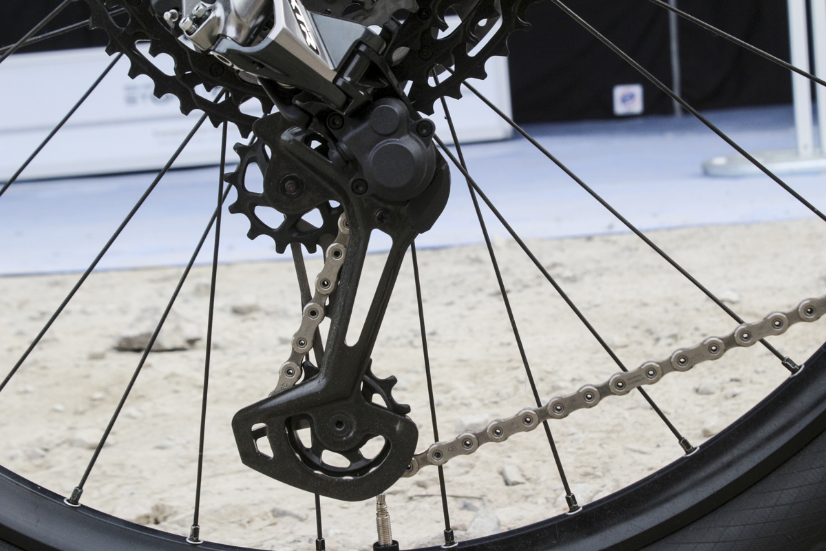

H+L screws set and indexing fettled to perfection, lubed with squirt and also tried smoove, yet chain is so noisy, compared to my other bike running XT 10 speed + KMC chain which is almost whisper quiet.
Bike is full XTR, and from a bit of googling I see Sram chains mentioned a lot for quietness, anyone reccomend, and which Sram chain too?

Double checked it's threaded through the cage correctly? We've all done it..
Posted : 22/07/2018 2:12 pm
I did it only yesterday!
Posted : 22/07/2018 2:40 pm
It came threaded wrong from LBS, was rubbing on the little noggin bit. Sorted that but still very noisy. I'll stick a video up later of the noise, may in fact be quiet just i'm used to Sram drivechain.
Which bit?
Posted : 23/07/2018 7:26 am
Thanks all for other chain suggestions will add all to list.
Aphex its now like this, but prior it was in front of that space you see in the mech arm, held there by the small plastic noggin, only rubbing mind in certain gear combos. (not my pic)
