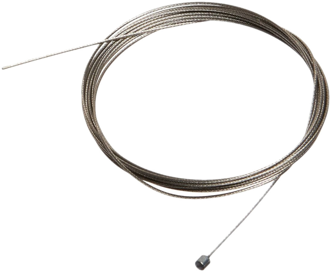

Posts: 2191
Posted by: sharkattack
this

And a cable is no use as it won't plug into mech or phone...
