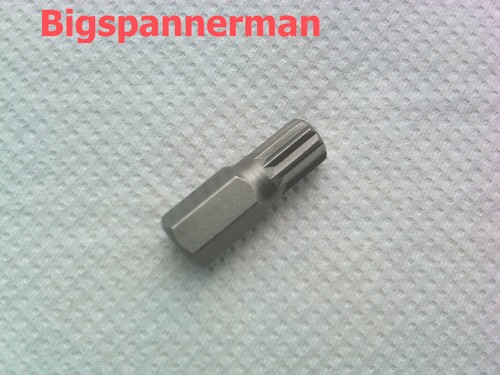

If this doesn't work you may need to try a spline such as a M10 (below) and hammer this into place.
Don't use normal allen/hex keys for this type of work as whilst they are perfectly ok for tightening stem bolts/seatpost clamps etc they are next to useless for this kind of work.
