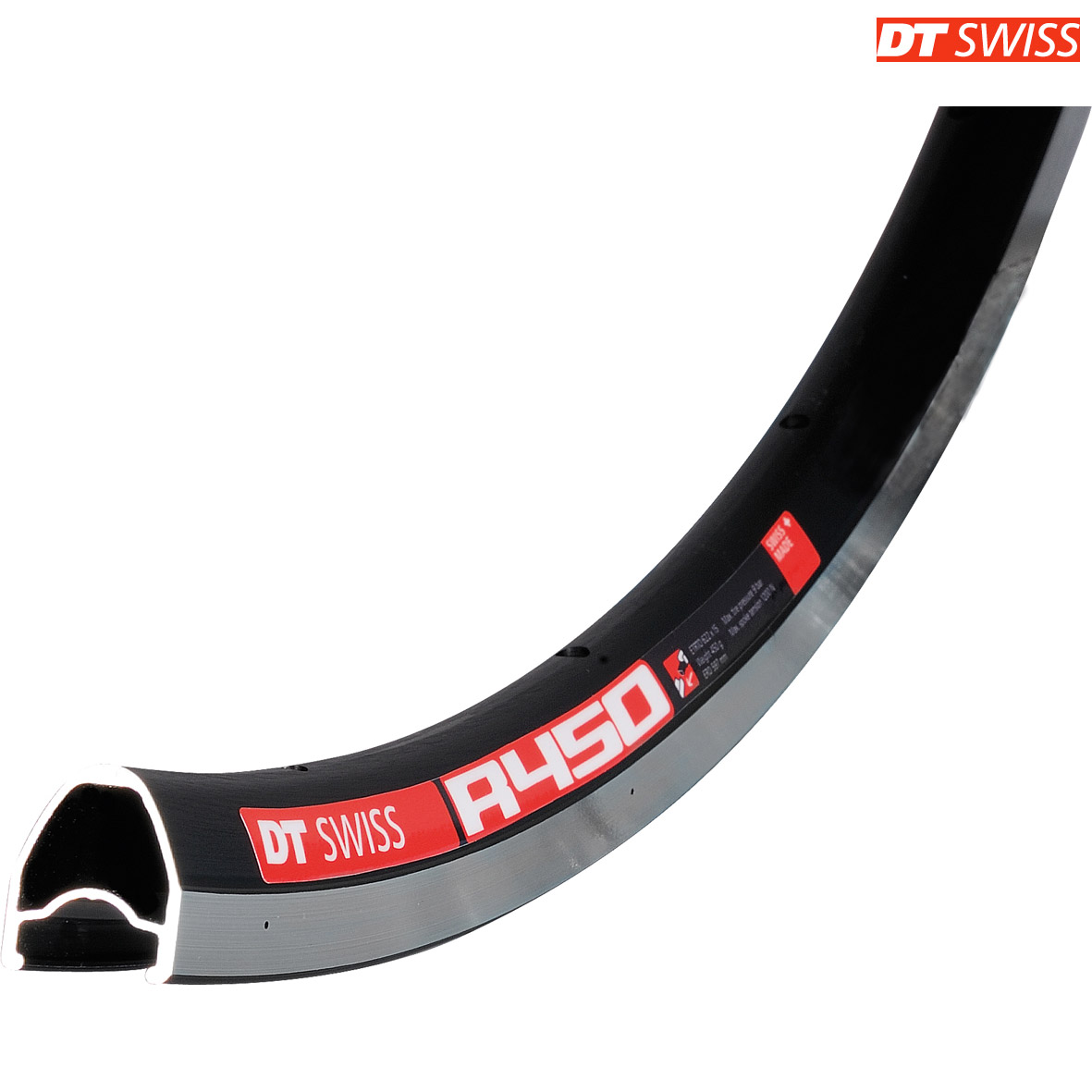

This could be a useful thread for the wheelbuiding newbie. Father Christmas brought me all the stuff I need to start, but I'm going for a new set of wheels for my commuter first, with these rims.
[img] [/img]Exciting!
Posted : 01/01/2014 9:48 am
